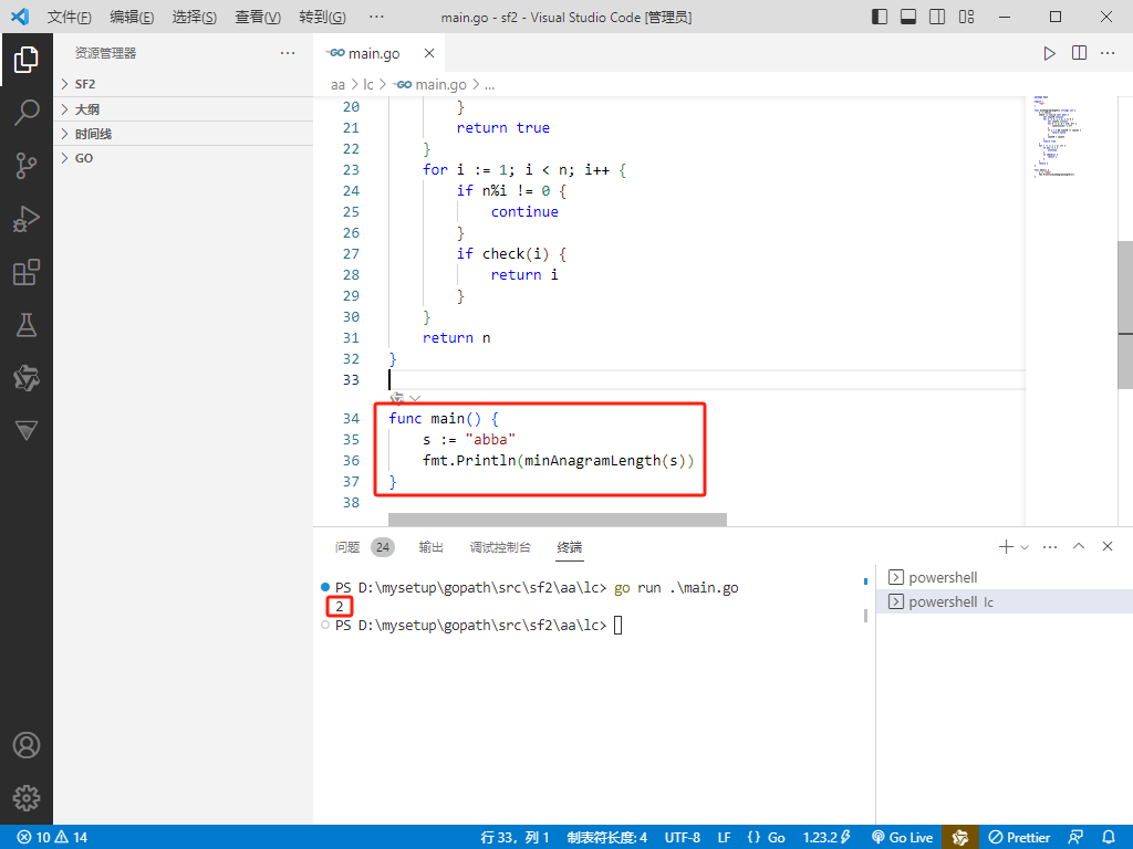

Go完整代码如下:
package main
import (
	"fmt"
func minAnagramLength(s string) int {
	n := len(s)
	check := func(m int) bool {
		var count0 [26]int
		for j := 0; j < n; j += m {
			var count1 [26]int
			for k := j; k < j+m; k++ {
				count1[s[k]-'a']++
			if j > 0 && count0 != count1 {
				return false
			count0 = count1
		return true
	for i := 1; i < n; i++ {
		if n%i != 0 {
			continue
		if check(i) {
			return i
	return n
func main() {
	s := "abba"
	fmt.Println(minAnagramLength(s))

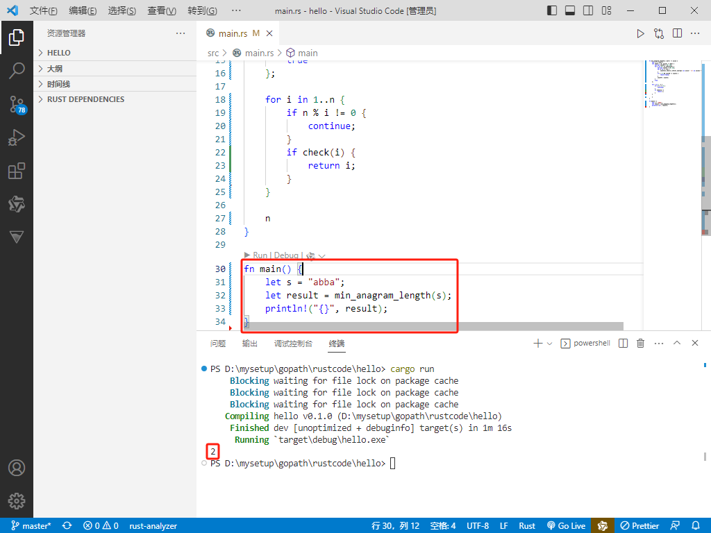

Rust完整代码如下:
fn min_anagram_length(s: &str) -> usize {
    let n = s.len();
    let check = |m: usize| -> bool {
        let mut count0 = [0; 26];
        for j in (0..n).step_by(m) {
            let mut count1 = [0; 26];
            for k in j..j+m {
                count1[s.chars().nth(k).unwrap() as usize - 'a' as usize] += 1;
                return false;
            count0 = count1;
        true
    for i in 1..n {
        if n % i != 0 {
            continue;
        if check(i) {
            return i;
    n
fn main() {
    let s = "abba";
    let result = min_anagram_length(s);
    println!("{}", result);
