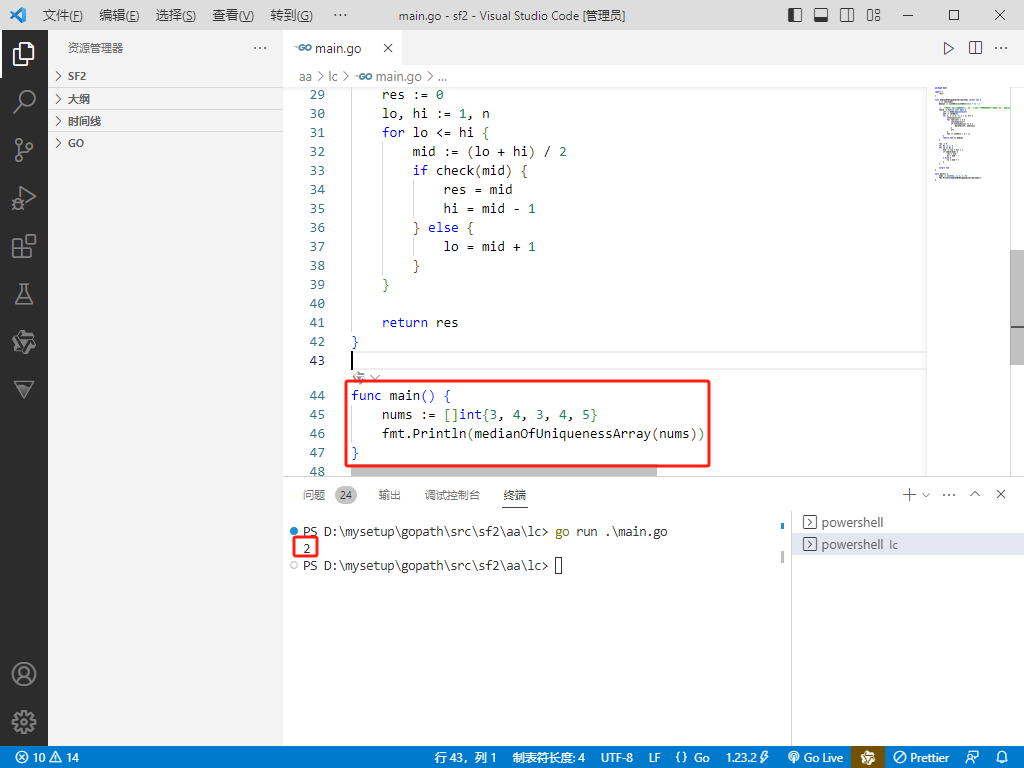

Go完整代码如下:
package main
import (
	"fmt"
func medianOfUniquenessArray(nums []int) int {
	n := len(nums)
	median := (int64(n)*int64(n+1)/2 + 1) / 2
	// 检测数组中不同元素数目小于等于 t 的连续子数组数目是否大于等于 median
	check := func(t int) bool {
		cnt := make(map[int]int)
		tot := int64(0)
		for i, j := 0, 0; i < n; i++ {
			cnt[nums[i]]++
			for len(cnt) > t {
				cnt[nums[j]]--
				if cnt[nums[j]] == 0 {
					delete(cnt, nums[j])
				j++
			tot += int64(i - j + 1)
		return tot >= median
	res := 0
	lo, hi := 1, n
	for lo <= hi {
		mid := (lo + hi) / 2
		if check(mid) {
			res = mid
			hi = mid - 1
		} else {
			lo = mid + 1
	return res
func main() {
	nums := []int{3, 4, 3, 4, 5}
	fmt.Println(medianOfUniquenessArray(nums))

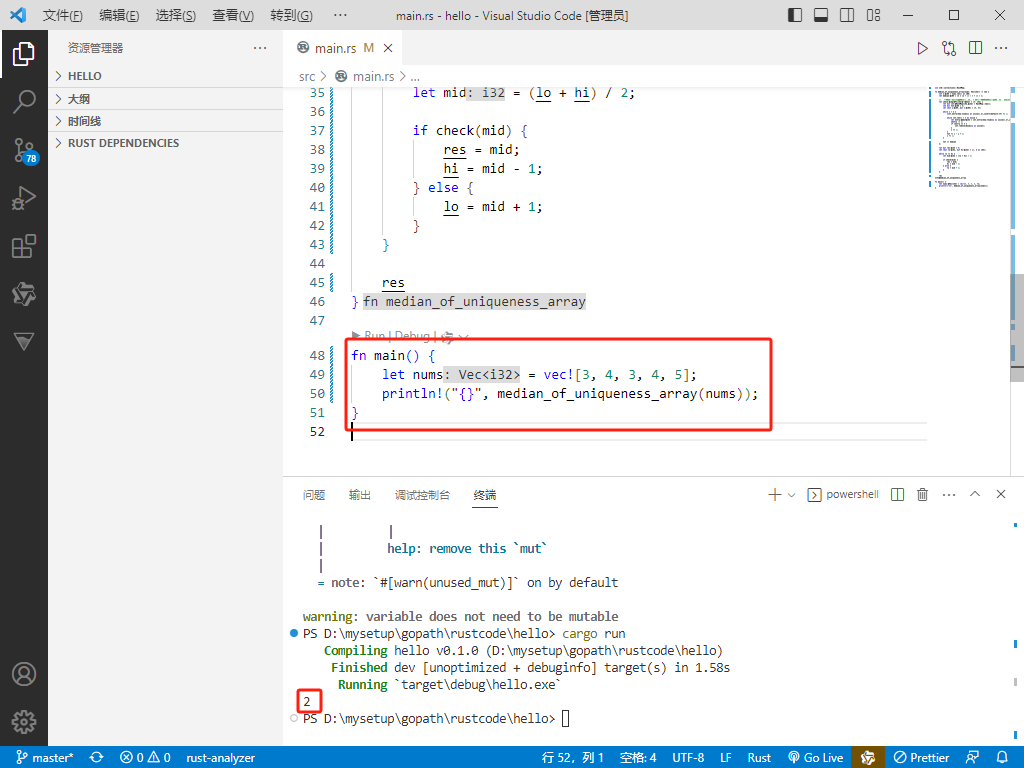

Rust完整代码如下:
use std::collections::HashMap;
fn median_of_uniqueness_array(nums: Vec<i32>) -> i32 {
    let n = nums.len() as i64;
    let median = (n * (n + 1) / 2 + 1) / 2;
    let check = |t: i32| {
        let mut cnt = HashMap::new();
        let mut tot = 0;
        let (mut j, mut i) = (0, 0);
        while i < n {
            *cnt.entry(nums[i as usize]).or_insert(0) += 1;
            while cnt.len() > t as usize {
                let entry = cnt.entry(nums[j as usize]).or_insert(0);
                *entry -= 1;
                if *entry == 0 {
                    cnt.remove(&nums[j as usize]);
                j += 1;
            tot += i - j + 1;
            i += 1;
        tot >= median
    let mut res = 0;
    let (mut lo, mut hi) = (1, n as i32);
    while lo <= hi {
        let mid = (lo + hi) / 2;
        if check(mid) {
            res = mid;
            hi = mid - 1;
        } else {
            lo = mid + 1;
    res
fn main() {
    let nums = vec![3, 4, 3, 4, 5];
    println!("{}", median_of_uniqueness_array(nums));
