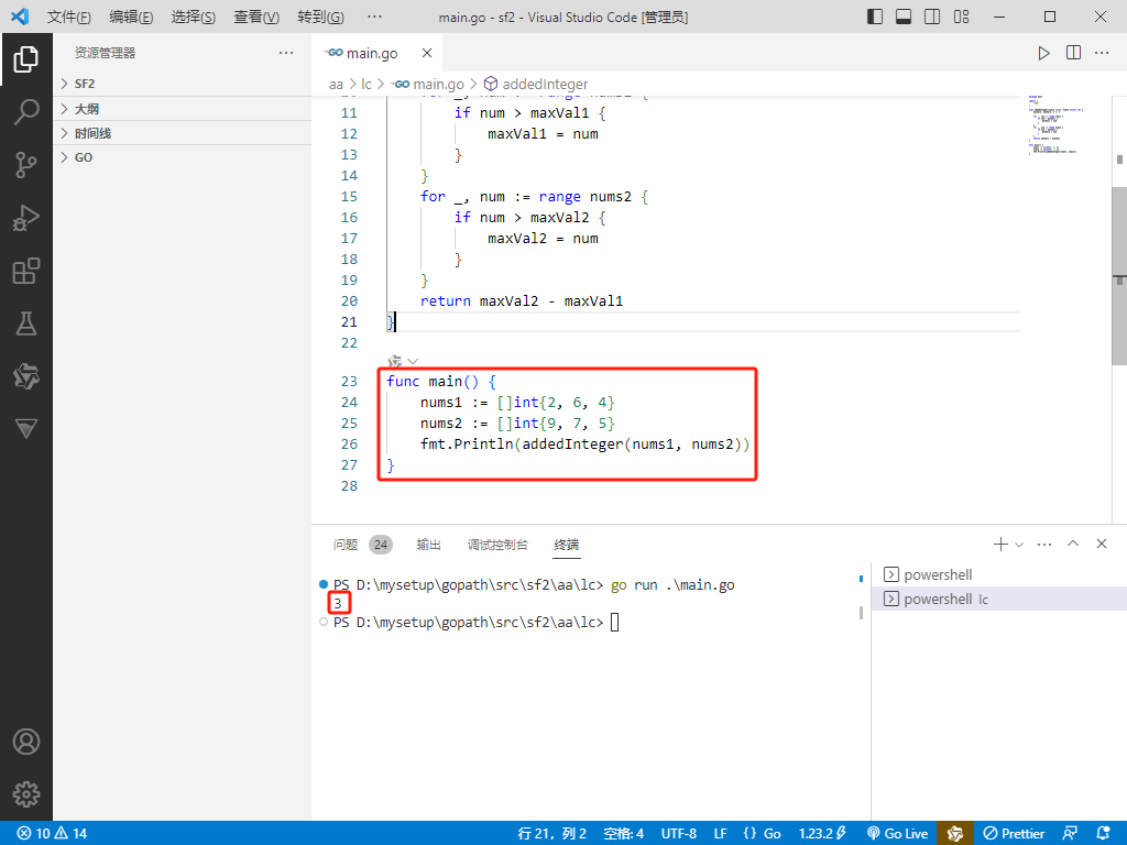

Go完整代码如下:
package main
import (
"fmt"
func addedInteger(nums1 []int, nums2 []int) int {
maxVal1, maxVal2 := 0, 0
for _, num := range nums1 {
if num > maxVal1 {
maxVal1 = num
for _, num := range nums2 {
if num > maxVal2 {
maxVal2 = num
return maxVal2 - maxVal1
func main() {
nums1 := []int{2, 6, 4}
nums2 := []int{9, 7, 5}
fmt.Println(addedInteger(nums1, nums2))

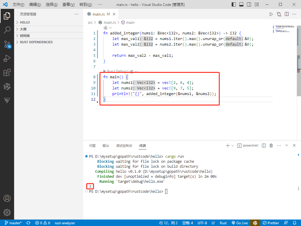

Rust完整代码如下:
fn added_integer(nums1: &Vec<i32>, nums2: &Vec<i32>) -> i32 {
let max_val1 = nums1.iter().max().unwrap_or(&0);
let max_val2 = nums2.iter().max().unwrap_or(&0);
return max_val2 - max_val1;
fn main() {
let nums1 = vec![2, 6, 4];
let nums2 = vec![9, 7, 5];
println!("{}", added_integer(&nums1, &nums2));
