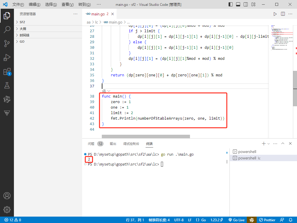

Go完整代码如下:
package main
import (
	"fmt"
func numberOfStableArrays(zero int, one int, limit int) int {
	dp := make([][][2]int, zero+1)
	mod := int(1e9 + 7)
	for i := 0; i <= zero; i++ {
		dp[i] = make([][2]int, one+1)
	for i := 0; i <= min(zero, limit); i++ {
		dp[i][0][0] = 1
	for j := 0; j <= min(one, limit); j++ {
		dp[0][j][1] = 1
	for i := 1; i <= zero; i++ {
		for j := 1; j <= one; j++ {
			if i > limit {
				dp[i][j][0] = dp[i-1][j][0] + dp[i-1][j][1] - dp[i-limit-1][j][1]
			} else {
			dp[i][j][0] = (dp[i][j][0]%mod + mod) % mod
			if j > limit {
				dp[i][j][1] = dp[i][j-1][1] + dp[i][j-1][0] - dp[i][j-limit-1][0]
			} else {
			dp[i][j][1] = (dp[i][j][1]%mod + mod) % mod
	return (dp[zero][one][0] + dp[zero][one][1]) % mod
func main() {

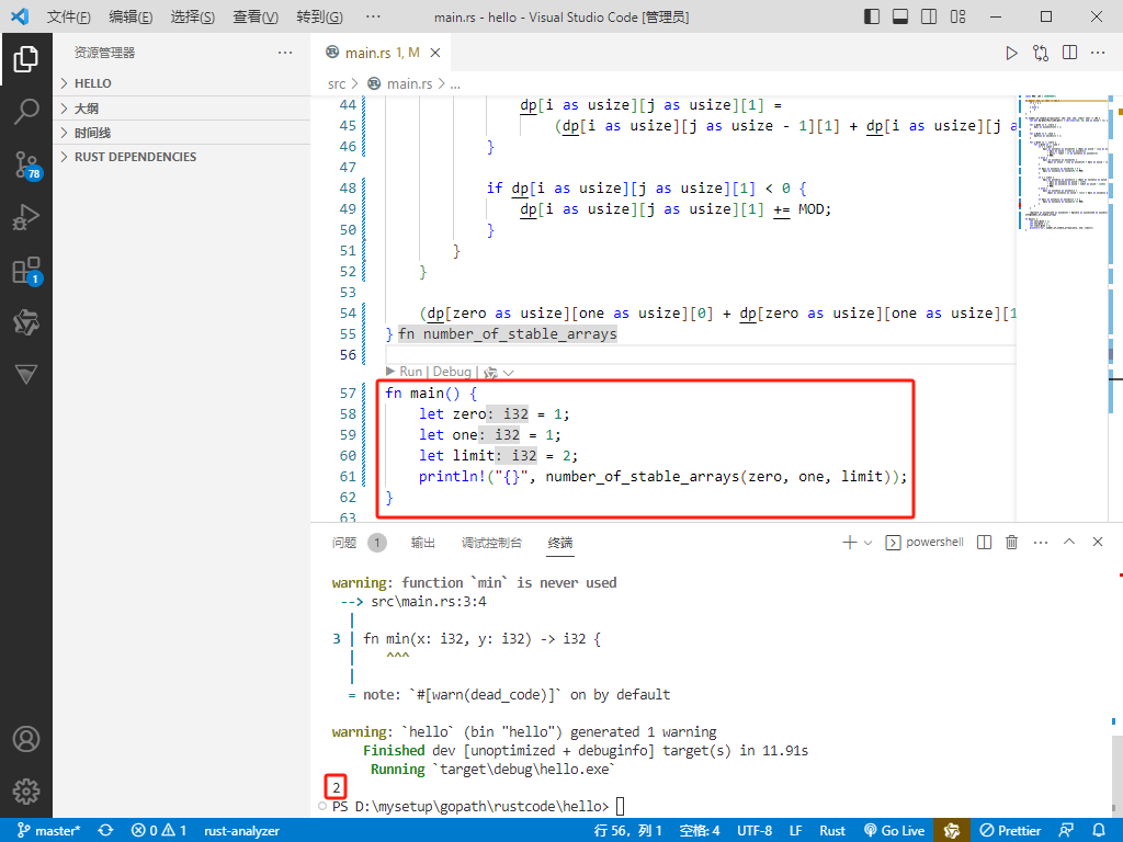

	zero := 1
	one := 1
	limit := 2
	fmt.Println(numberOfStableArrays(zero, one, limit))

fn main() {
    let zero = 1;
    let one = 1;
    let limit = 2;
    println!("{}", number_of_stable_arrays(zero, one, limit));
