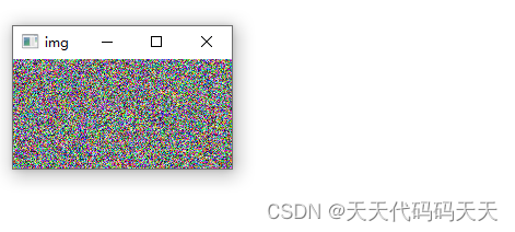

改变一行代码,创建彩色的随机图像,代码如下:
int width = 200;
int height = 100;
Mat img = new Mat(height, width, MatType.CV_8UC3);
Random random = new Random();
for (int i = 0; i < height; i++)
    for (int j = 0; j < width; j++)
        byte blue = (byte)(random.NextDouble() * 256);
        byte green = (byte)(random.NextDouble() * 256);
        byte red = (byte)(random.NextDouble() * 256);
        Vec3b color = new Vec3b((byte)blue, (byte)green, (byte)red);
        img.At<Vec3b>(i, j) = color;
Cv2.ImShow("img", img);
Cv2.WaitKey();
Cv2.DestroyAllWindows();
效果:
