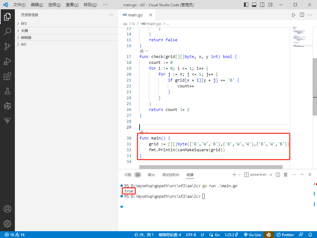

Go完整代码如下:
package main
import (
	"fmt"
func canMakeSquare(grid [][]byte) bool {
    for i := 0; i <= 1; i++ {
        for j := 0; j <= 1; j++ {
            if check(grid, i, j) {
                return true
    return false
func check(grid[][]byte, x, y int) bool {
    count := 0
            if grid[x + i][y + j] == 'B' {
                count++
    return count != 2
func main() {

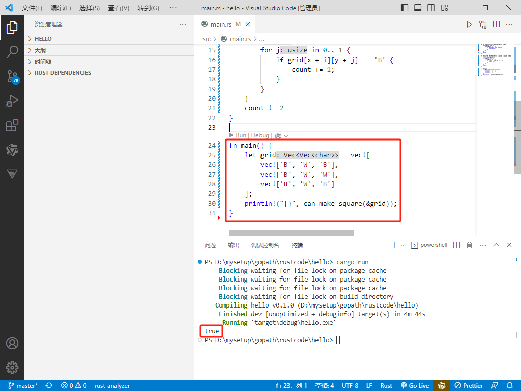

	grid := [][]byte{{'B','W','B'},{'B','W','W'},{'B','W','B'}}
	fmt.Println(canMakeSquare(grid))
Rust完整代码如下:
fn can_make_square(grid: &Vec<Vec<char>>) -> bool {
    for i in 0..=1 {
        for j in 0..=1 {
                return true;
    false
fn check(grid: &Vec<Vec<char>>, x: usize, y: usize) -> bool {
    let mut count = 0;
    for i in 0..=1 {
        for j in 0..=1 {
                count += 1;
    count != 2
fn main() {
    let grid = vec![
        vec!['B', 'W', 'B'],
        vec!['B', 'W', 'W'],
        vec!['B', 'W', 'B']
    println!("{}", can_make_square(&grid));
