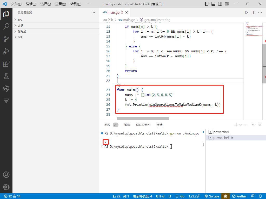

Go完整代码如下:
package main
import (
	"fmt"
	"slices"
func minOperationsToMakeMedianK(nums []int, k int) (ans int64) {
	slices.Sort(nums)
	m := len(nums) / 2
	if nums[m] > k {
		for i := m; i >= 0 && nums[i] > k; i-- {
			ans += int64(nums[i] - k)
	} else {
		for i := m; i < len(nums) && nums[i] < k; i++ {
			ans += int64(k - nums[i])
	return
func main() {
	nums := []int{2,5,6,8,5}
	k := 4
	fmt.Println(minOperationsToMakeMedianK(nums, k))
