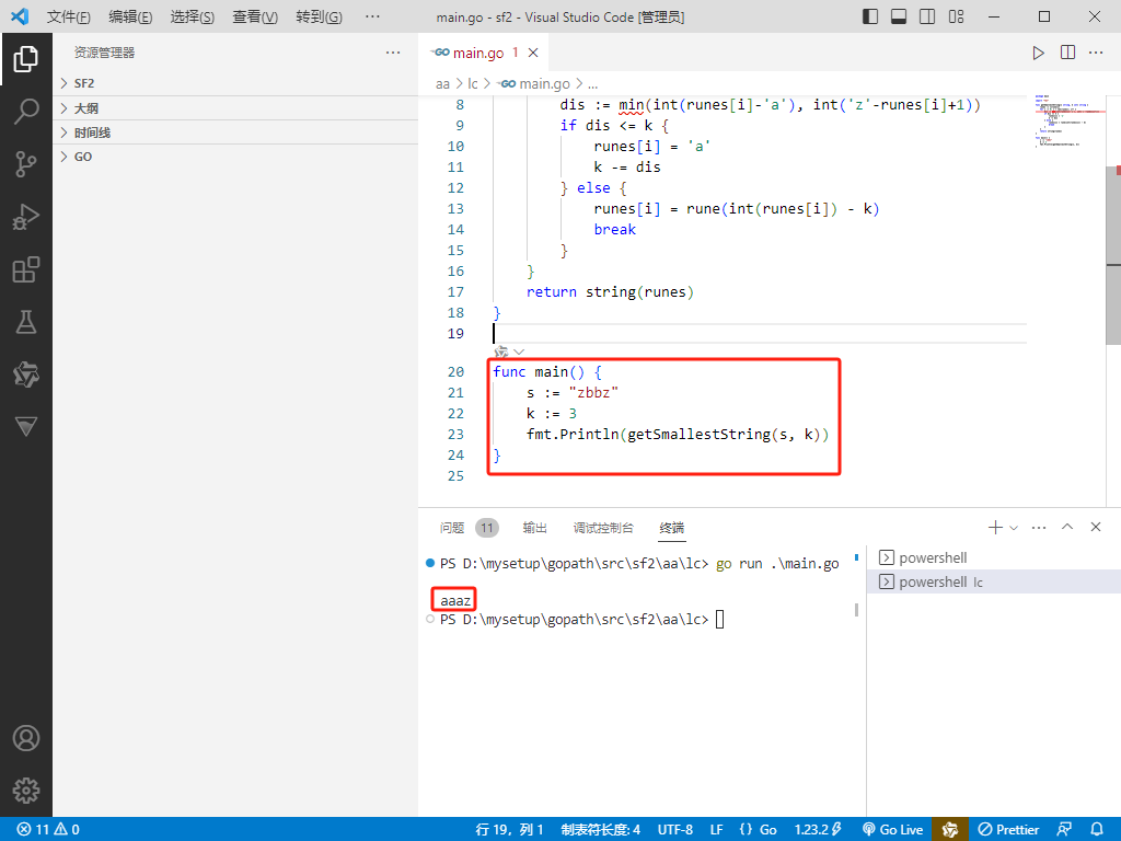

Go完整代码如下:
package main
import "fmt"
func getSmallestString(s string, k int) string {
	runes := []rune(s)
	for i := 0; i < len(runes); i++ {
		dis := min(int(runes[i]-'a'), int('z'-runes[i]+1))
		if dis <= k {
			runes[i] = 'a'
			k -= dis
		} else {
			runes[i] = rune(int(runes[i]) - k)
			break
	return string(runes)
func main() {
	s := "zbbz"
	k := 3
	fmt.Println(getSmallestString(s, k))

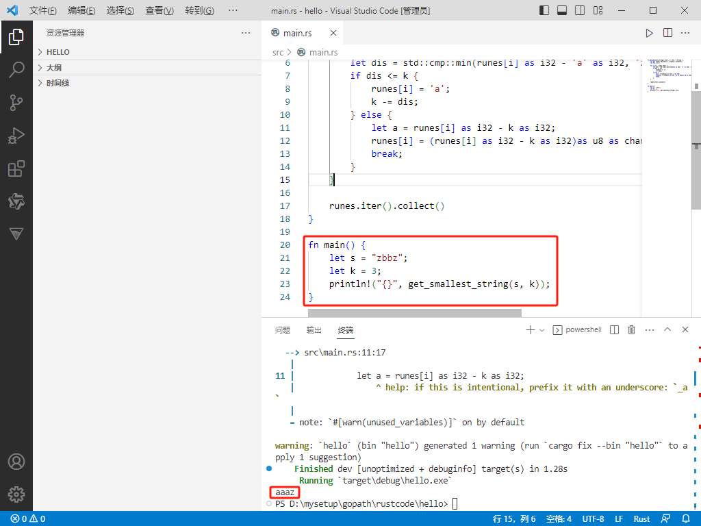

Rust完整代码如下:
fn get_smallest_string(s: &str, k: i32) -> String {
    let mut runes: Vec<char> = s.chars().collect();
    let mut k = k;
    for i in 0..runes.len() {
        let dis = std::cmp::min(runes[i] as i32 - 'a' as i32, 'z' as i32 - runes[i] as i32 + 1);
        if dis <= k {
            runes[i] = 'a';
            k -= dis;
        } else {
            let a = runes[i] as i32 - k as i32;
            runes[i] = (runes[i] as i32 - k as i32)as u8 as char;
            break;
    runes.iter().collect()
fn main() {
    let s = "zbbz";
    let k = 3;
    println!("{}", get_smallest_string(s, k));
