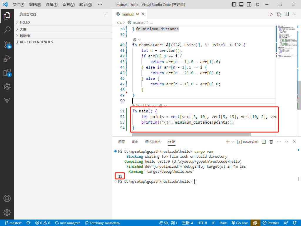

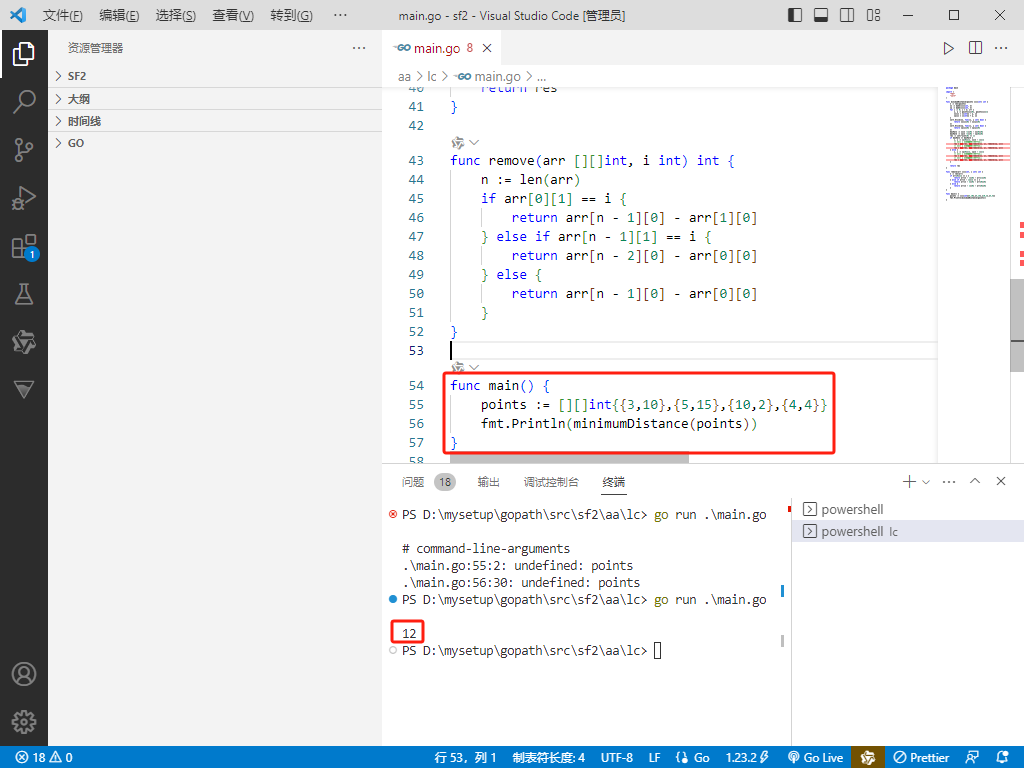

func main() {
	points := [][]int{{3,10},{5,15},{10,2},{4,4}}
	fmt.Println(minimumDistance(points))
Rust完整代码如下:

fn main() {
    let points = vec![vec![3, 10], vec![5, 15], vec![10, 2], vec![4, 4]];
    println!("{}", minimum_distance(points));
