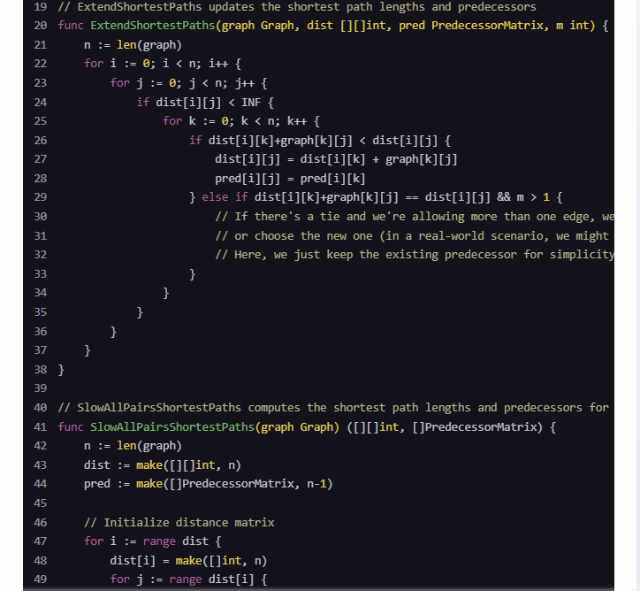

// ExtendShortestPaths updates the shortest path lengths and predecessors
func ExtendShortestPaths(graph Graph, dist [][]int, pred PredecessorMatrix, m int) {
	n := len(graph)
	for i := 0; i < n; i++ {
		for j := 0; j < n; j++ {
			if dist[i][j] < INF {
				for k := 0; k < n; k++ {
					if dist[i][k]+graph[k][j] < dist[i][j] {
						dist[i][j] = dist[i][k] + graph[k][j]
						pred[i][j] = pred[i][k]
					} else if dist[i][k]+graph[k][j] == dist[i][j] && m > 1 {
						// If there's a tie and we're allowing more than one edge, we can keep the existing predecessor
						// or choose the new one (in a real-world scenario, we might need a more sophisticated tie-breaking strategy)
						// Here, we just keep the existing predecessor for simplicity
// SlowAllPairsShortestPaths computes the shortest path lengths and predecessors for all pairs
func SlowAllPairsShortestPaths(graph Graph) ([][]int, []PredecessorMatrix) {
	n := len(graph)
	dist := make([][]int, n)
	pred := make([]PredecessorMatrix, n-1)
	// Initialize distance matrix
	for i := range dist {
		dist[i] = make([]int, n)
		for j := range dist[i] {
			if i == j {
				dist[i][j] = 0
			} else {
				dist[i][j] = INF

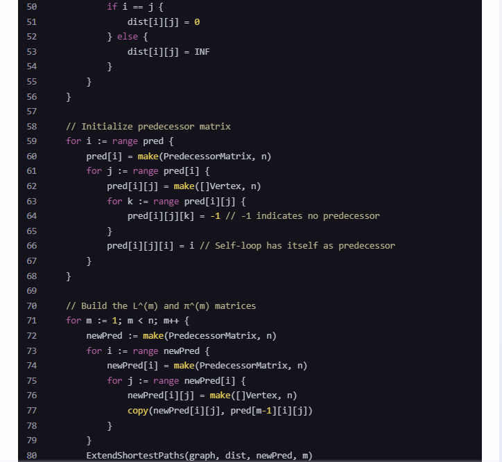

	// Initialize predecessor matrix
	for i := range pred {
		pred[i] = make(PredecessorMatrix, n)
		for j := range pred[i] {
			pred[i][j] = make([]Vertex, n)
			for k := range pred[i][j] {
				pred[i][j][k] = -1 // -1 indicates no predecessor
			pred[i][j][i] = i // Self-loop has itself as predecessor
	// Build the L^(m) and π^(m) matrices
	for m := 1; m < n; m++ {
		newPred := make(PredecessorMatrix, n)
		for i := range newPred {
			newPred[i] = make(PredecessorMatrix, n)
			for j := range newPred[i] {
				newPred[i][j] = make([]Vertex, n)
				copy(newPred[i][j], pred[m-1][i][j])
		ExtendShortestPaths(graph, dist, newPred, m)
		pred[m-1] = newPred
	return dist, pred

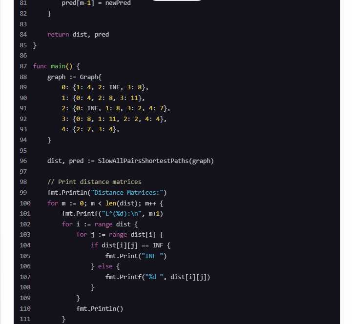

func main() {
	graph := Graph{
		0: {1: 4, 2: INF, 3: 8},
		1: {0: 4, 2: 8, 3: 11},
		2: {0: INF, 1: 8, 3: 2, 4: 7},
		3: {0: 8, 1: 11, 2: 2, 4: 4},
		4: {2: 7, 3: 4},
	dist, pred := SlowAllPairsShortestPaths(graph)
	// Print distance matrices
	fmt.Println("Distance Matrices:")
	for m := 0; m < len(dist); m++ {
		fmt.Printf("L^(%d):\n", m+1)
				if dist[i][j] == INF {
					fmt.Print("INF ")
				} else {
					fmt.Printf("%d ", dist[i][j])
			fmt.Println()
		fmt.Println()

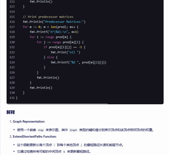

	// Print predecessor matrices
	fmt.Println("Predecessor Matrices:")
	for m := 0; m < len(pred); m++ {
		fmt.Printf("π^(%d):\n", m+1)
		for i := range pred[m] {
			for j := range pred[m][i] {
				if pred[m][i][j] == -1 {
					fmt.Print("nil ")
				} else {
					fmt.Printf("%d ", pred[m][i][j])
			fmt.Println()
		fmt.Println()
解释
  1. Graph Representation:
    • 使用一个嵌套 map 来表示图,其中 Graph 类型的键和值分别表示顶点和该顶点相邻顶点的权重。
  2. ExtendShortestPaths Function:
    • 这个函数更新从每个顶点 i 到每个其他顶点 j 的最短路径长度和前驱节点。
    • 它通过检查所有可能的中间顶点 k 来更新最短路径。
    • 如果找到一条更短的路径,则更新距离和前驱节点。
    • 如果路径长度相同且允许超过一条边(m > 1),则保持当前前驱节点(或根据特定策略选择新的前驱节点)。

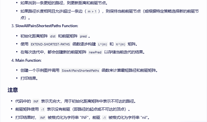

  3. SlowAllPairsShortestPaths Function:
    • 初始化距离矩阵 dist 和前驱矩阵 pred
    • 使用 EXTEND-SHORTEST-PATHS 函数逐步构建 L^(m)π^(m) 矩阵。
    • 在每次迭代中,都会创建新的前驱矩阵 newPred 以存储当前迭代的结果。
  4. Main Function:
    • 创建一个示例图并调用 SlowAllPairsShortestPaths 函数来计算最短路径和前驱矩阵。
    • 打印结果。
注意
  • 代码中的 INF 表示无穷大,用于初始化距离矩阵中表示不可达的路径。
  • 前驱矩阵使用 -1 表示没有前驱(即路径的起点或不可达的顶点)。
  • 打印结果时,INF 被格式化为字符串 “INF”,前驱 -1 被格式化为字符串 “nil”。

    LNew := make([][]int, n)
    IINew := make([][][]int, n)
    for i := range LNew {
        LNew[i] = make([]int, n)
        IINew[i] = make([][](int), n)
        for j := range LNew[i] {
            LNew[i][j] = INF
            IINew[i][j] = make([]int, 0)
                if L[i][k]+W[k][j] < LNew[i][j] {
                    LNew[i][j] = L[i][k] + W[k][j]
                    IINew[i][j] = []int{k}
                } else if L[i][k]+W[k][j] == LNew[i][j] {
                    IINew[i][j] = append(IINew[i][j], k)
    return LNew, IINew
// SLOW - ALL - PAIRS - SHORTEST - PATHS函数的修改版
func SLOW - ALL - PAIRS - SHORTEST - PATHS(W [][]int) ([][]int, [][][]int) {
    n := len(W)
    L := make([][]int, n)
    II := make([][][]int, n)
    for i := range L {
        L[i] = make([]int, n)
        II[i] = make([][](int), n)
        for j := range L[i] {
            L[i][j] = W[i][j]
            if i!= j && L[i][j] < INF {
                II[i][j] = []int{i}
            } else {
                II[i][j] = make([]int, 0)
    for m := 2; m < n; m++ {
        L, II = EXTEND - SHORTESTPATHS(L, II, W)
    return L, II
你可以使用以下方式调用这些函数:
func main() {
    // 示例权重矩阵W
    W := [][]int{
        {0, 3, INF, 7},
        {8, 0, 2, INF},
        {5, INF, 0, 1},
        {2, INF, INF, 0},
    L, II := SLOW - ALL - PAIRS - SHORTEST - PATHS(W)
    // 输出最短路径权重矩阵L
    fmt.Println("最短路径权重矩阵L:")
    for _, row := range L {
        for _, num := range row {
            if num == INF {
                fmt.Printf("INF ")
            } else {
                fmt.Printf("%d ", num)
        fmt.Println()
    // 输出前驱矩阵II
    fmt.Println("前驱矩阵II:")
    for _, row := range II {
        for _, subRow := range row {
            fmt.Printf("%v ", subRow)
        fmt.Println()
  1. EXTEND - SHORTESTPATHS函数
    • 这个函数接受当前的最短路径权重矩阵L、前驱矩阵II和权重矩阵W
    • 对于每一对节点(i, j),它遍历中间节点k,计算L[i][k]+W[k][j]
    • 如果这个值小于当前的LNew[i][j],则更新LNew[i][j]为这个新值,并将IINew[i][j]设置为[k](表示kj的前驱)。
    • 如果这个值等于当前的LNew[i][j],则将k添加到IINew[i][j]中(因为可能有多个最短路径)。
    • 最后返回更新后的最短路径权重矩阵LNew和前驱矩阵IINew
  2. SLOW - ALL - PAIRS - SHORTEST - PATHS函数
    • 这个函数首先初始化最短路径权重矩阵L和前驱矩阵II为输入的权重矩阵W
    • 对于从2到n - 1m,它调用EXTEND - SHORTESTPATHS函数来逐步更新LII
    • 最后返回计算得到的最短路径权重矩阵L和前驱矩阵II
  3. main函数
    • 这里创建了一个示例的权重矩阵W
    • 调用SLOW - ALL - PAIRS - SHORTEST - PATHS函数得到最短路径权重矩阵L和前驱矩阵II
    • 然后分别输出LII
