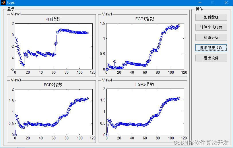

% --- Executes on button press in pushbutton6.
function pushbutton6_Callback(hObject, eventdata, handles)
% hObject handle to pushbutton6 (see GCBO)
% eventdata reserved - to be defined in a future version of MATLAB
% handles structure with handles and user data (see GUIDATA)
global Signal
global Lipschitz
KHI = func_KHI(Lipschitz);
axes(handles.axes1);
plot(KHI,'b-o');
title('KHIָ ');
FGP1 = func_FGP1(Lipschitz);
axes(handles.axes3);
plot(FGP1,'b-o');
title('FGP1ָ ');
FGP2 = func_FGP2(Lipschitz);
axes(handles.axes2);
plot(FGP2,'b-o');
title('FGP2ָ ');
FGP3 = func_FGP3(FGP2,0.5);
axes(handles.axes4);
plot(FGP3,'b-o');
title('FGP3ָ ');
