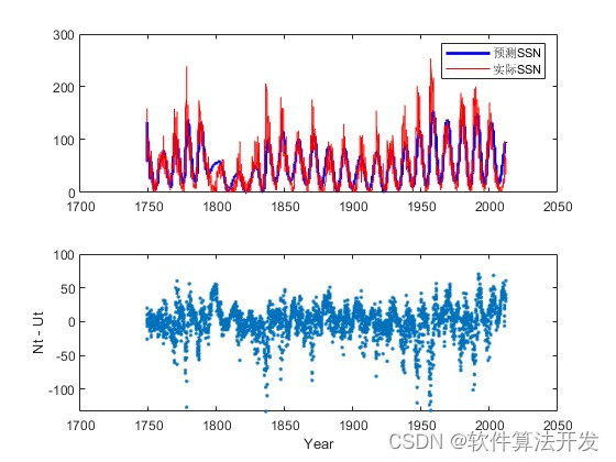

figure;
plot(YEAR2,SSN,'r');hold off;
legend('预测SSN','实际SSN');
grid on;

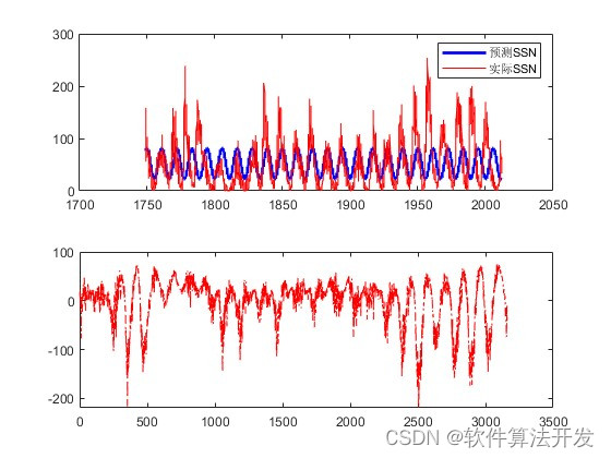

16_013m
