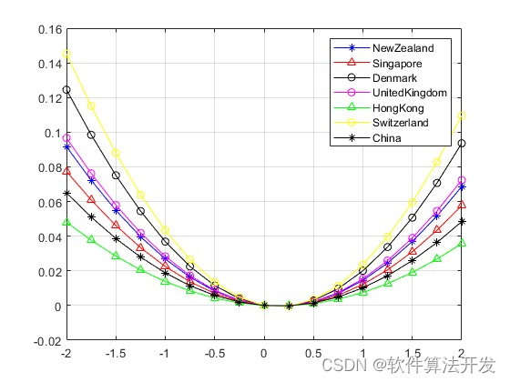

figure;
plot(tmps,T{9},'b-*');hold on
plot(tmps,T{10},'r-^');hold on
plot(tmps,T{4},'k-o');hold on
plot(tmps,T{14},'m-o');hold on
plot(tmps,T{5},'g-^');hold on
plot(tmps,T{11},'y-o');hold on
plot(tmps,T{3},'k-*');hold on
grid on
legend('NewZealand','Singapore','Denmark','UnitedKingdom','HongKong','Switzerland','China');
