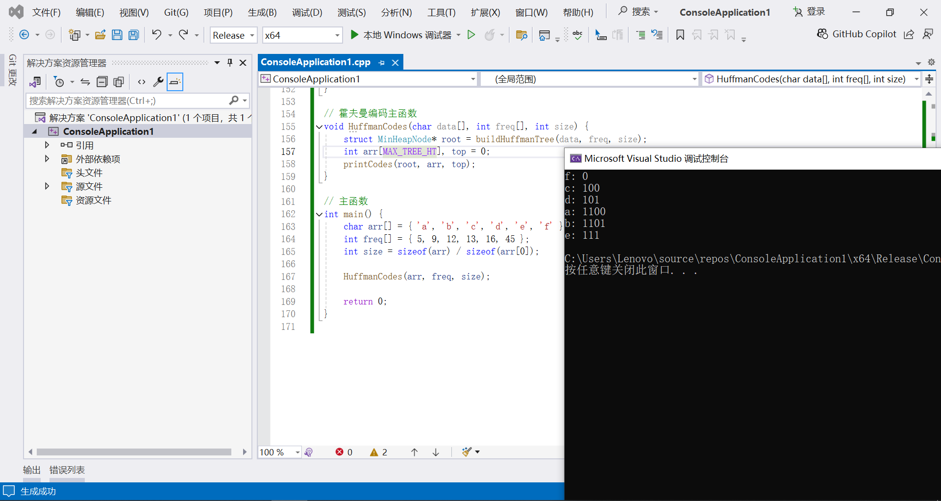

void HuffmanCodes(char data[], int freq[], int size) {
    struct MinHeapNode* root = buildHuffmanTree(data, freq, size);
    int arr[MAX_TREE_HT], top = 0;
    printCodes(root, arr, top);
// 主函数
int main() {
    char arr[] = { 'a', 'b', 'c', 'd', 'e', 'f' };
    int freq[] = { 5, 9, 12, 13, 16, 45 };
    int size = sizeof(arr) / sizeof(arr[0]);
    HuffmanCodes(arr, freq, size);
    return 0;
image-20240807112718442

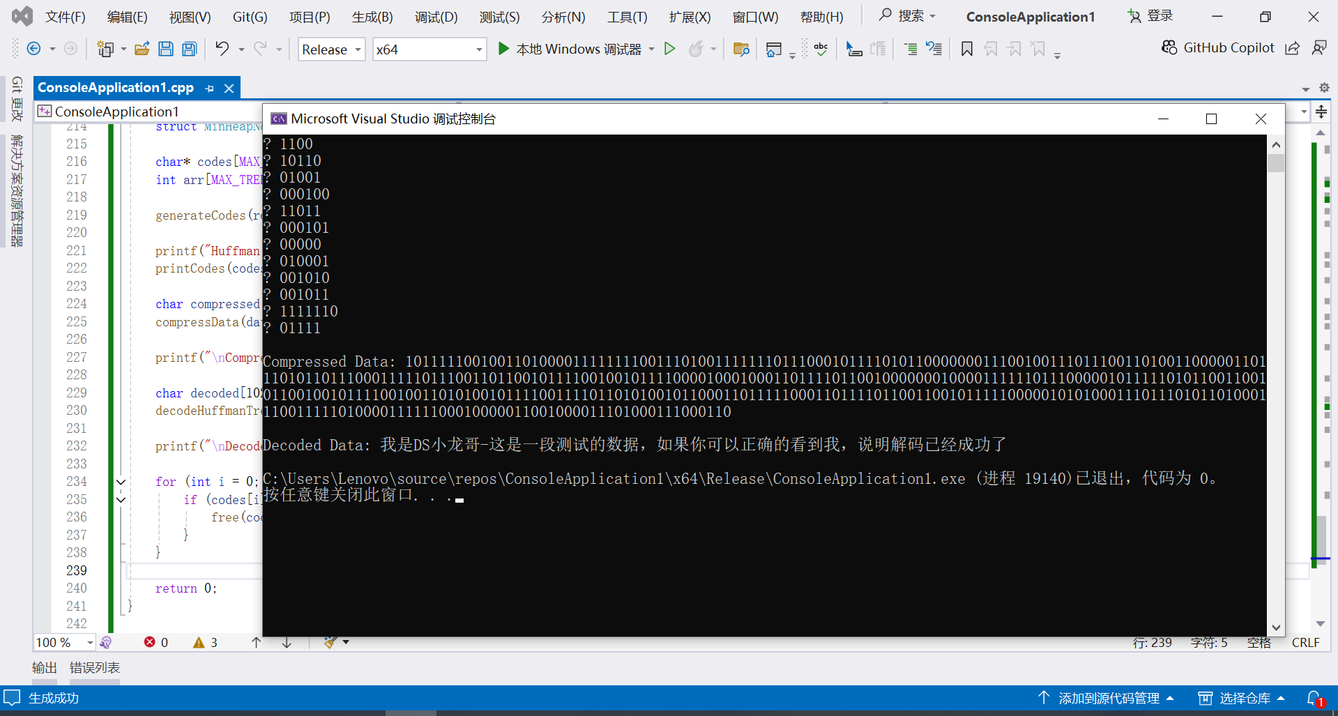

int main() {
    const char* data = "我是DS小龙哥-这是一段测试的数据,如果你可以正确的看到我,说明解码已经成功了";
    int freq[MAX_CHAR] = { 0 };
    for (int i = 0; data[i]; i++) {
        freq[(unsigned char)data[i]]++;
    unsigned char uniqueChars[MAX_CHAR];
    int uniqueFreqs[MAX_CHAR];
    int size = 0;
    for (int i = 0; i < MAX_CHAR; i++) {
        if (freq[i]) {
            uniqueChars[size] = i;
            uniqueFreqs[size] = freq[i];
            size++;
    struct MinHeapNode* root = buildHuffmanTree(uniqueChars, uniqueFreqs, size);
    char* codes[MAX_CHAR] = { 0 };
    generateCodes(root, arr, top, codes);
    printf("Huffman Codes:\n");
    printCodes(codes);
    char compressed[1024] = { 0 };
    compressData(data, codes, compressed);
    printf("\nCompressed Data: %s\n", compressed);
    char decoded[1024] = { 0 };
    decodeHuffmanTree(root, compressed, decoded);
    printf("\nDecoded Data: %s\n", decoded);

在主函数中,统计输入数据中每个字符的频率,然后构建霍夫曼树,生成编码表,对输入数据进行压缩,最后再对压缩后的数据进行解码,并打印结果。代码在实现霍夫曼编码和解码过程中,展示了从频率统计、树的构建、编码生成到数据压缩和解码的完整流程。
