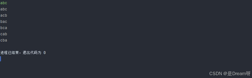

样例输入
abc
样例输出
abc
acb
bac
bca
cab
cba
AC代码
lst = list(input())
lst.sort()
n = len(lst)
result = [0] * n
used = [False] * n
def permutation(i):
    if i == n:
        for x in result:
            print(x,end="")
        print("")
        return
    for k in range(n):
        if not used[k]:
            result[i] = lst[k]
            used[k] = True
            permutation(i+1)
            used[k] = False
permutation(0)
