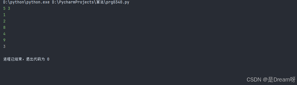

样例输入
5 3
2
8
4
9
样例输出
3
AC代码
FJ can put his 3 cows in the stalls at positions 1, 4 and 8, resulting in a minimum distance of 3.
FJ 可以将他的 3 头奶牛放在 1、4 和 8 位置的畜栏中,最小距离为 3。
Huge input data,scanf is recommended.
输入数据量大,建议使用scanf。
N,C = map(int,input().split())
x = []
for i in range(N):
x.append(int(input()))
x.sort()
def valid(d):
prevPos = x[0]
totalDone = 1
for i in range(1,N):
if x[i] - prevPos >= d:
prevPos = x[i]
totalDone += 1
if totalDone == C:
return True
return False
L,R = 1, 1000000000//(C-1) + 1
best = 0
while L <= R:
D = L + (R - L)//2
if valid(D):
best = D
L = D + 1
else:
R = D - 1
print(best)
