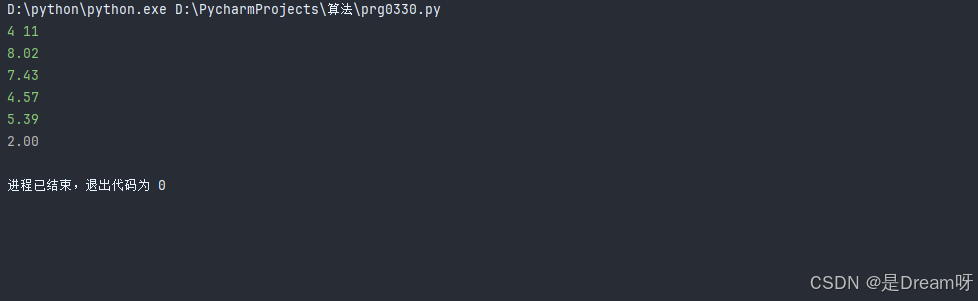

样例输入
4 11
8.02
7.43
4.57
5.39
样例输出
2.00
AC代码
N,K = map(int,input().split())
a = []
for i in range(N):
	a.append(int(float(input())*100))
L,R = 1, max(a)
best = 0
def valid(L):
	total = 0
	for i in range(N):
		total += a[i] // L
		if total >= K:
			return True
	return False
while L <= R:
	mid = L + (R - L)//2
	if valid(mid):
		best = mid
		L = mid + 1
	else:
		R = mid - 1
print("%.2f" % (best/100))
