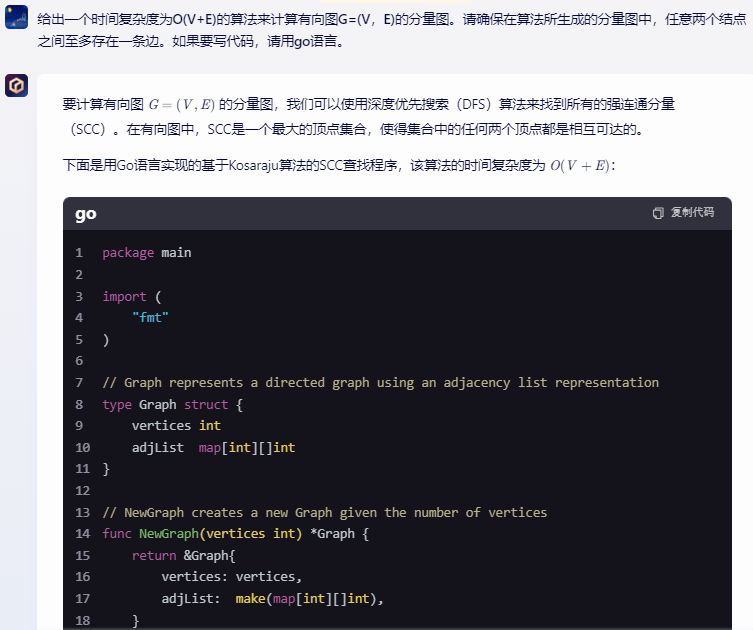

【摘要】 五、给出一个时间复杂度为O(V+E)的算法来计算有向图G=(V,E)的分量图。请确保在算法所生成的分量图中,任意两个结点之间至多存在一条边。如果要写代码,请用go语言。 文心一言:要计算有向图 $ G = (V, E) $ 的分量图,我们可以使用深度优先搜索(DFS)算法来找到所有的强连通分量(SCC)。在有向图中,SCC是一个最大的顶点集合,使得集合中的任何两个顶点都是相互可达的。下面是...
文心一言:
下面是用Go语言实现的基于Kosaraju算法的SCC查找程序,该算法的时间复杂度为 $ O(V + E) $:
package main
import (
    "fmt"
// Graph represents a directed graph using an adjacency list representation
type Graph struct {
    vertices int
    adjList  map[int][]int
// NewGraph creates a new Graph given the number of vertices
func NewGraph(vertices int) *Graph {
    return &Graph{
        vertices: vertices,
        adjList:  make(map[int][]int),

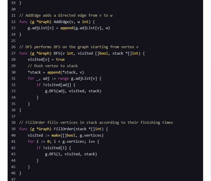

// AddEdge adds a directed edge from v to w
func (g *Graph) AddEdge(v, w int) {
    g.adjList[v] = append(g.adjList[v], w)
// DFS performs DFS on the graph starting from vertex v
func (g *Graph) DFS(v int, visited []bool, stack *[]int) {
    visited[v] = true
    // Push vertex to stack
    *stack = append(*stack, v)
    for _, adj := range g.adjList[v] {
        if !visited[adj] {
            g.DFS(adj, visited, stack)
// FillOrder fills vertices in stack according to their finishing times
func (g *Graph) FillOrder(stack *[]int) {
    visited := make([]bool, g.vertices)
    for i := 0; i < g.vertices; i++ {
        if !visited[i] {
            g.DFS(i, visited, stack)

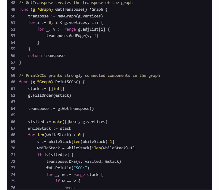

// GetTranspose creates the transpose of the graph
func (g *Graph) GetTranspose() *Graph {
    transpose := NewGraph(g.vertices)
        for _, v := range g.adjList[i] {
            transpose.AddEdge(v, i)
    return transpose
// PrintSCCs prints strongly connected components in the graph
func (g *Graph) PrintSCCs() {
    stack := []int{}
    g.FillOrder(&stack)
    transpose := g.GetTranspose()
    whileStack := stack
    for len(whileStack) > 0 {
        v := whileStack[len(whileStack)-1]
        whileStack = whileStack[:len(whileStack)-1]
        if !visited[v] {
            transpose.DFS(v, visited, &stack)
            fmt.Println("SCC:")
            for _, w := range stack {
                if w == v {
                    break
                fmt.Print(w, " ")
            fmt.Println(v)
            stack = []int{}

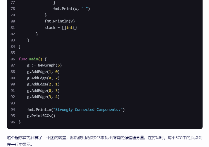

func main() {
    g := NewGraph(5)
    g.AddEdge(1, 0)
    g.AddEdge(0, 2)
    g.AddEdge(2, 1)
    g.AddEdge(0, 3)
    g.AddEdge(3, 4)
    fmt.Println("Strongly Connected Components:")
    g.PrintSCCs()
这个程序首先计算了一个图的转置,然后使用两次DFS来找出所有的强连通分量。在打印时,每个SCC中的顶点会在一行中显示。
