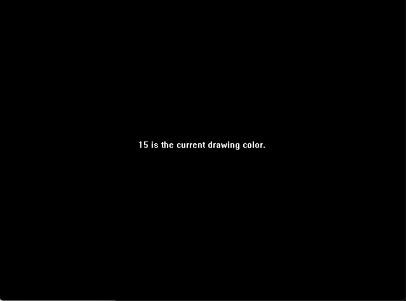

6.2 演示示例
#include <graphics.h>
int main(void)
    int gdriver = DETECT, gmode, errorcode;
    int color, midx, midy;
    char colname[35];
    initgraph(&gdriver, &gmode, "");
    errorcode = graphresult();
    /* an error occurred */
    if (errorcode != grOk)
        printf("Graphics error: %s\n", grapherrormsg(errorcode));
        printf("Press any key to halt:");
        getch();
        exit(1);
    midx = getmaxx() / 2;
    midy = getmaxy() / 2;
    setcolor(getmaxcolor());
    settextjustify(CENTER_TEXT, CENTER_TEXT);
    for (int i = WHITE; i > 0; i--)
        color = getcolor();
        itoa(color, colname, 10);
        strcat(colname, " is the current drawing color.");
        outtextxy(midx, midy, colname);
        getch();
        cleardevice();
        setcolor(i - 1);
    getch();
    closegraph();
    return 0;
上述程序,通过使用图形库,在一个循环中遍历所有颜色,每次在屏幕中心显示当前颜色的名称和值,等待用户按键后更改颜色并清除屏幕,直到所有颜色展示完毕。
6.3 运行结果
