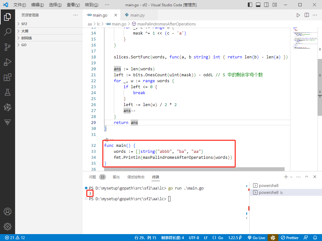

Go完整代码如下:
package main
import (
	"fmt"
	"math/bits"
	"slices"
func maxPalindromesAfterOperations(words []string) int {
	oddL, mask := 0, 0
	for _, w := range words {
		oddL += len(w) % 2 // 统计奇数长度字符串个数
		for _, c := range w {
			mask ^= 1 << (c - 'a')
	slices.SortFunc(words, func(a, b string) int { return len(b) - len(a) })
	ans := len(words)
	left := bits.OnesCount(uint(mask)) - oddL // S 中的剩余字母个数
		if left <= 0 {
			break
		left -= len(w) / 2 * 2
		ans--
	return ans
func main() {
	words := []string{"abbb", "ba", "aa"}
	fmt.Println(maxPalindromesAfterOperations(words))

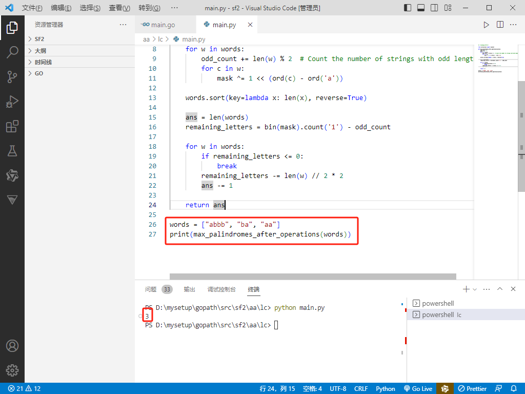

Python完整代码如下:
# -*-coding:utf-8-*-
from collections import Counter
def max_palindromes_after_operations(words):
    odd_count = 0
    mask = 0
    for w in words:
        odd_count += len(w) % 2  # Count the number of strings with odd length
        for c in w:
            mask ^= 1 << (ord(c) - ord('a'))
    words.sort(key=lambda x: len(x), reverse=True)
    ans = len(words)
    remaining_letters = bin(mask).count('1') - odd_count
    for w in words:
        if remaining_letters <= 0:
            break
        remaining_letters -= len(w) // 2 * 2
        ans -= 1
    return ans
words = ["abbb", "ba", "aa"]
print(max_palindromes_after_operations(words))
