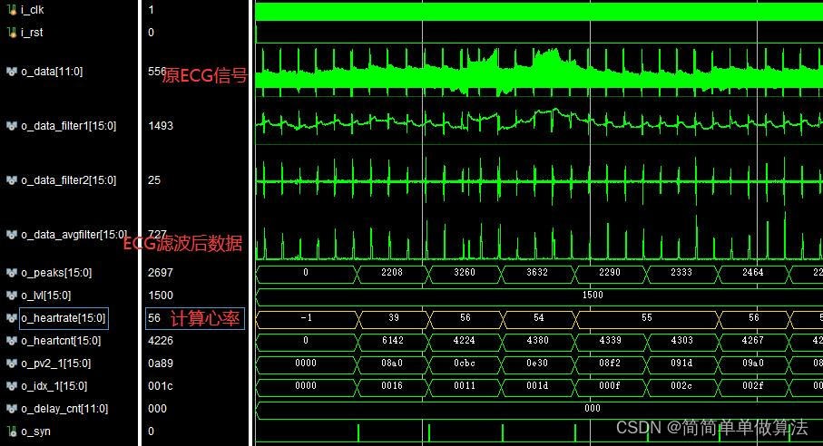

1.算法运行效果图预览

4.部分核心程序
//调用心率数据
ECG_data ECG_data_u(
    .i_clk (i_clk),
    .i_rst (i_rst),
    .o_data(o_data)
//low filter
wire signed[31:0]w_channel_output1;
fir_lower fir_lower_u(
	.aresetn            (~i_rst), // input sclr
	.aclk               (i_clk), // input clk
	.s_axis_data_tvalid (1'b1), // output rfd
	.s_axis_data_tready (),
	.s_axis_data_tdata  ({o_data[11],o_data[11],o_data[11],o_data[11],o_data}),
    .m_axis_data_tvalid (),
	.m_axis_data_tdata(w_channel_output1) // output [24 : 0] dout
assign o_data_filter1=w_channel_output1[25:10];
//high filter//这里和论文不一样,我再增加一个高频滤波
wire signed[31:0]w_channel_output2;
fir_higher higher_filter_u(
	.s_axis_data_tdata  ({o_data_filter1}),
	.m_axis_data_tdata(w_channel_output2) // output [24 : 0] dout
assign o_data_filter2=w_channel_output2[25:10];
//平均滤波
avg_filters avg_filters_u(
    .i_clk       (i_clk),
    .i_rst       (i_rst),
    .i_data      (o_data_filter2),
    .o_avg_filter(o_data_avgfilter)
wire[15:0]o_pv2_1;
dyn_lvl dyn_lvl_u(
    .i_clk   (i_clk),
    .i_rst   (i_rst),
    .i_agcamp(16'd1500),
    .i_pv2_1 (o_pv2_1),
    .o_lvl   (o_lvl)
find_heart_max find_heart_max_u(
    .i_clk      (i_clk),
    .i_rst      (i_rst),
    .i_lvl      (o_lvl),
    .i_peak     (o_data_avgfilter),
    .o_pv2_1    (o_pv2_1),
    .o_idx_1    (o_idx_1),
    .o_delay_cnt(o_delay_cnt),
    .o_syn      (o_syn),
    .curr_state (),
    .cnten      (),
    .cnt0       (),
    .cnt1       (),
    .cnt2       (),
    .cnt3       (),
    .cnt4       (),
    .max_1      (),
    .max_2      (),
    .max_3      (),
    .max_4      ()
assign o_peaks = o_pv2_1;
//计算心率
heart_rate_cal heart_rate_cal_u(
    .i_clk(i_clk),
    .i_rst(i_rst),
    .i_heart    (o_syn),
    .o_heartrate(o_heartrate),
    .o_heartcnt (o_heartcnt)
endmodule
