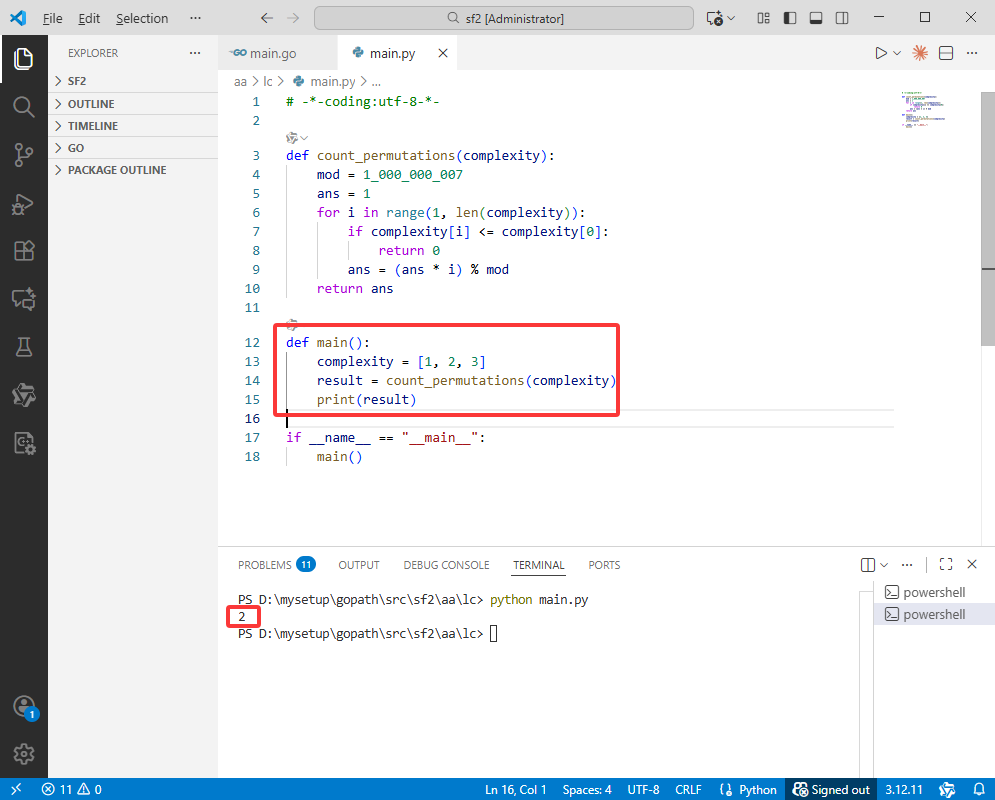

Python完整代码如下:
# -*-coding:utf-8-*-
def count_permutations(complexity):
    mod = 1_000_000_007
    ans = 1
    for i in range(1, len(complexity)):
        if complexity[i] <= complexity[0]:
            return 0
        ans = (ans * i) % mod
    return ans
def main():
    complexity = [1, 2, 3]
    result = count_permutations(complexity)
    print(result)
if __name__ == "__main__":
    main()

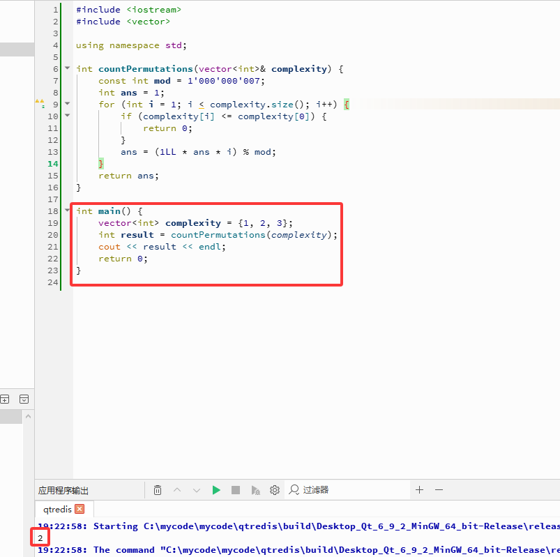

C++完整代码如下:
#include <iostream>
#include <vector>
using namespace std;
int countPermutations(vector<int>& complexity) {
    const int mod = 1'000'000'007;
    int ans = 1;
    for (int i = 1; i < complexity.size(); i++) {
        if (complexity[i] <= complexity[0]) {
            return 0;
        ans = (1LL * ans * i) % mod;
    return ans;
int main() {
    vector<int> complexity = {1, 2, 3};
    int result = countPermutations(complexity);
    cout << result << endl;
    return 0;
