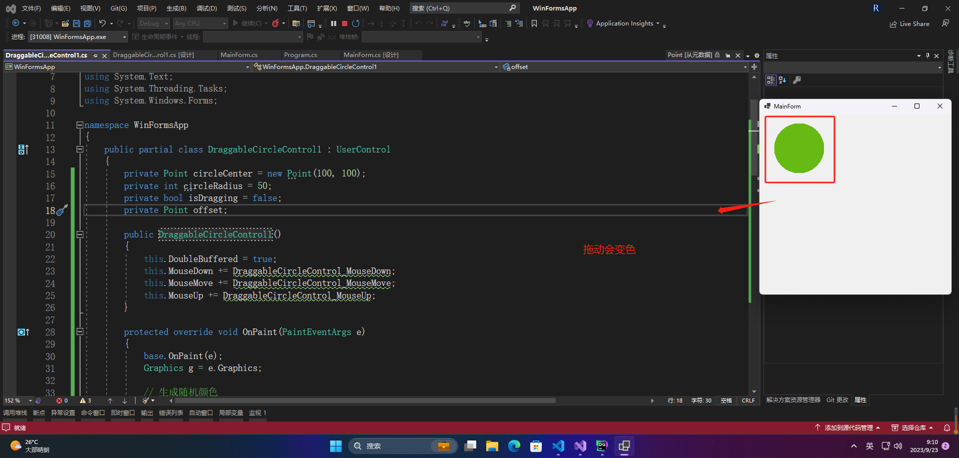

🔎6.案例
要在 WinForms 中使用 GDI+ 绘制一个随机颜色的圆,并支持鼠标拖动以改变圆的位置,您可以创建一个自定义的 Control
,然后在其 Paint
事件处理程序中绘制圆形,并在 MouseDown
、MouseMove
和 MouseUp
事件处理程序中实现鼠标拖动功能。以下是一个简单的示例:
using System;
using System.Drawing;
using System.Windows.Forms;
public class DraggableCircleControl1: DraggableCircleControl1
private Point circleCenter = new Point(100, 100);
private int circleRadius = 50;
private bool isDragging = false;
private Point offset;
public DraggableCircleControl1()
this.DoubleBuffered = true;
this.MouseDown += DraggableCircleControl_MouseDown;
this.MouseMove += DraggableCircleControl_MouseMove;
this.MouseUp += DraggableCircleControl_MouseUp;
protected override void OnPaint(PaintEventArgs e)
base.OnPaint(e);
Graphics g = e.Graphics;
// 生成随机颜色
Random random = new Random();
Color randomColor = Color.FromArgb(random.Next(256), random.Next(256), random.Next(256));
// 绘制圆形
using (SolidBrush brush = new SolidBrush(randomColor))
g.FillEllipse(brush, circleCenter.X - circleRadius, circleCenter.Y - circleRadius, circleRadius * 2, circleRadius * 2);
private void DraggableCircleControl_MouseDown(object sender, MouseEventArgs e)
if (e.Button == MouseButtons.Left)
// 检查鼠标是否在圆内部
int dx = e.X - circleCenter.X;
int dy = e.Y - circleCenter.Y;
if (dx * dx + dy * dy <= circleRadius * circleRadius)
isDragging = true;
offset = new Point(dx, dy);
private void DraggableCircleControl_MouseMove(object sender, MouseEventArgs e)
if (isDragging)
// 更新圆的位置
circleCenter = new Point(e.X - offset.X, e.Y - offset.Y);
this.Invalidate(); // 重新绘制控件
private void DraggableCircleControl_MouseUp(object sender, MouseEventArgs e)
isDragging = false;
public class MainForm : Form
public MainForm()
this.Size = new Size(400, 400);
this.Controls.Add(new DraggableCircleControl1());
[STAThread]
static void Main()
Application.EnableVisualStyles();
Application.Run(new MainForm());
上述代码创建了一个自定义的 DraggableCircleControl
控件,该控件绘制一个随机颜色的圆,支持鼠标拖动以改变圆的位置。将该控件添加到 MainForm
中,并运行应用程序即可看到效果。
