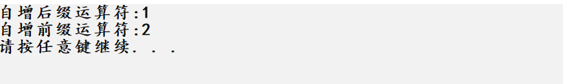

#include <stdio.h>
int main(void)
	int a = 1;
	int b = a++;//自增后缀运算符
	int d = 1;
	int c = ++d;//自增前缀运算符
	printf("自增后缀运算符:%d\n",b);
	printf("自增前缀运算符:%d\n", c);
    return 0;
