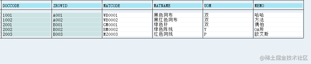

select *  from  ZWDEMOTABLE1 into CORRESPONDING FIELDS OF TABLE gt_Data .
sort  gt_Data by  doccode  zrowid.
READ TABLE gt_Data  into   gs_DAta WITH  KEY doccode = '2001' BINARY SEARCH .
WRITE :gs_DAta-doccode .
WRITE :gs_DAta-zrowid .
WRITE :gs_DAta-matcode .
WRITE :gs_DAta-matname .
结果
