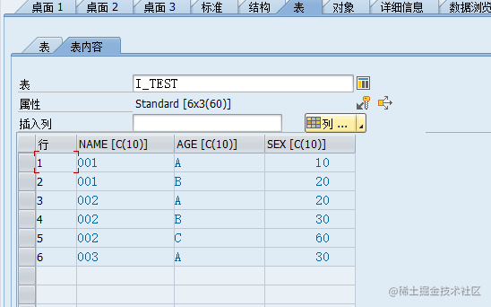

数据准备
创建数据后,数据一定要排序.
W_TEST-name = '001'.
W_TEST-age = 'A'.
W_TEST-sex = 10.
APPEND W_TEST TO I_TEST.
W_TEST-NAME = '001'.
W_TEST-age = 'B'.
W_TEST-sex = 20.
W_TEST-NAME = '002'.
W_TEST-age = 'A'.
W_TEST-sex = 20.
W_TEST-age = 'B'.
W_TEST-sex = 30.
W_TEST-age = 'C'.
W_TEST-sex = 60.
W_TEST-NAME = '003'.
W_TEST-age = 'A'.
W_TEST-sex = 30.
