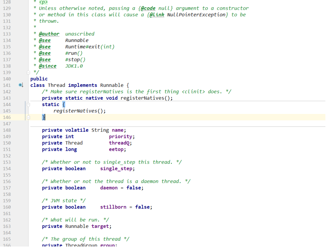

        表面上看没什么啊?这不都一样么?但更严谨的说法是看源码
/Lambda判断是否是函数型接口@FunctionalInterfacepublic interface Runnable {    /**     * When an object implementing interface <code>Runnable</code> is used     * to create a thread, starting the thread causes the object's     * <code>run</code> method to be called in that separately executing     * thread.     * <p>     * The general contract of the method <code>run</code> is that it may     * take any action whatsoever.     *     * @see     java.lang.Thread#run()     */    public abstract void run();}
 源码中表示:There are two ways to create a new thread of execution.一个是new Thread(),一个是实现Runable()接口

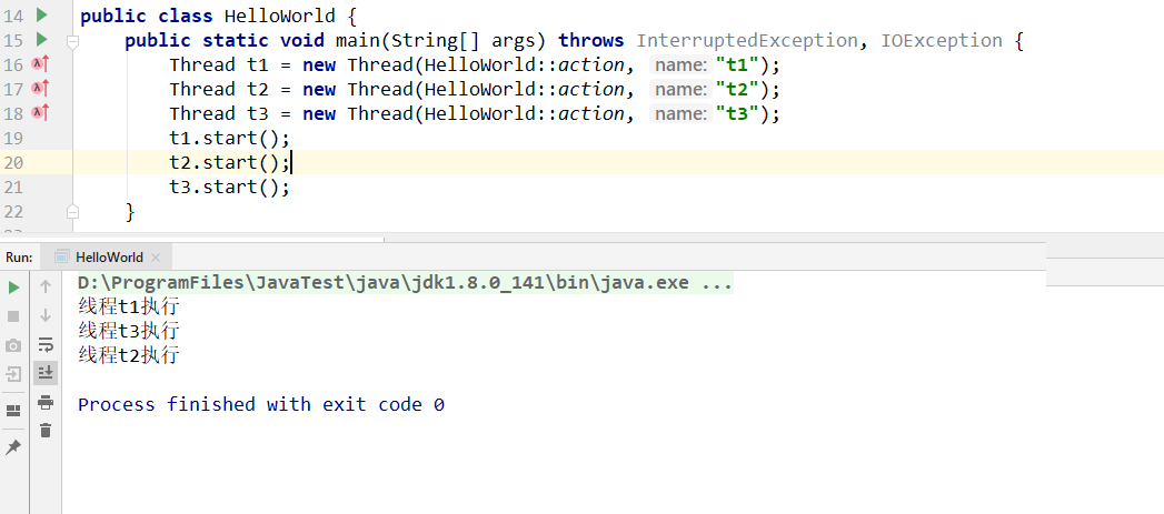

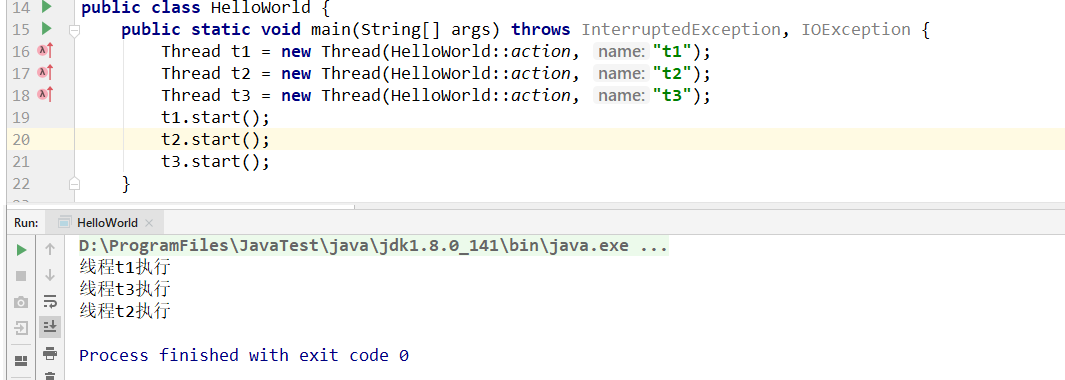

先看下t1.start,t2.startt3.start执行顺序
第一次
第二次
可以看到,多线程环境下,执行顺序与书写顺序每次都不一定相同
