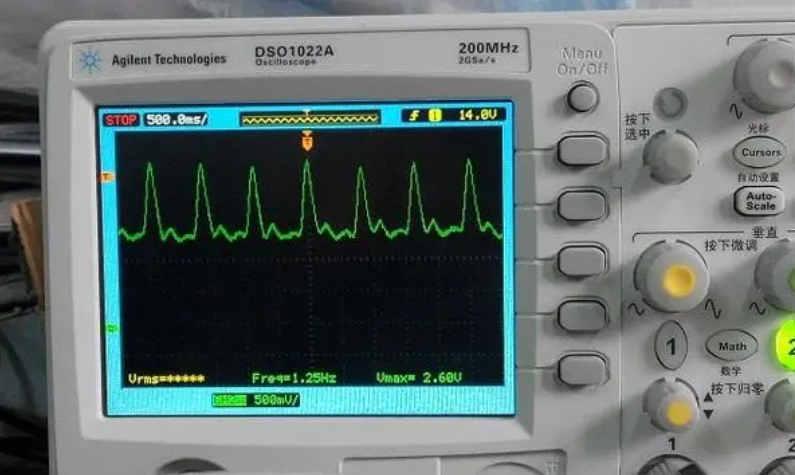

image-20230531174546382
image-20230531174339078
image-20230531174253160
