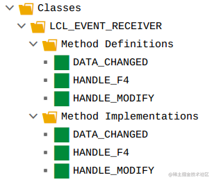

OO ABAP 中的类/接口有着独特的事件
OO ABAP 中的类/接口以及属性和函数都有事件。事件概念是 OO ABAP的一个重要特征,其中一个对象引发事件;根据开发要求,数据变更、数据修改、搜索帮助时用到。
类定义如下:
CLASS lcl_event_receiver DEFINITION.
  PUBLIC SECTION.
    METHODS data_changed FOR EVENT data_changed OF cl_gui_alv_grid
      IMPORTING er_data_changed
                  e_onf4
                  e_onf4_before
                  e_onf4_after
                  e_ucomm.
    METHODS handle_modify
                  FOR EVENT data_changed_finished OF cl_gui_alv_grid
      IMPORTING e_modified et_good_cells.
    METHODS handle_f4 FOR EVENT onf4 OF cl_gui_alv_grid
      IMPORTING e_fieldname
                  es_row_no
                  er_event_data
                  et_bad_cells
                  e_display.
ENDCLASS.                    "LCL_EVENT_RECEIVER DEFINITION
方法实现如下:
CLASS lcl_event_receiver IMPLEMENTATION.
  METHOD data_changed.
    PERFORM handle_data_changed USING er_data_changed.
  ENDMETHOD.
  METHOD handle_modify.
    PERFORM handle_data_finish USING e_modified et_good_cells.
  ENDMETHOD.                    "HANDLE_MODIFY
  METHOD handle_f4.
    FIELD-SYMBOLS: <fs_alv> LIKE gs_out.
    CASE e_fieldname.
      " 写自己的逻辑
    ENDCASE.
* 设置后,alv稳定刷新
    PERFORM refresh_table_alv.
  ENDMETHOD.
ENDCLASS.                    "LCL_EVENT_RECEIVER IMPLEMENTATION
FORM refresh_table_alv .
  gs_stbl-row = 'X'." 基于行的稳定刷新
  gs_stbl-col = 'X'." 基于列稳定刷新
  CALL METHOD gcl_alv_grid->refresh_table_display
    EXPORTING
      is_stable = gs_stbl.
ENDFORM. " REFRESH_TABLE_ALV
