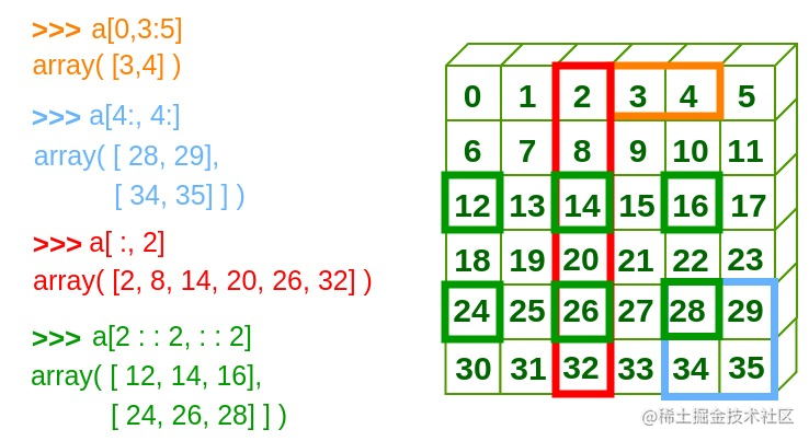

代码#2:
# 用于基本切片和索引的 Python 程序
import numpy as np
# A 3-Dimensional array
a = np.array([[0, 1, 2, 3, 4, 5]
              [6, 7, 8, 9, 10, 11]
              [12, 13, 14, 15, 16, 17]
              [18, 19, 20, 21, 22, 23]
              [24, 25, 26, 27, 28, 29]
              [30, 31, 32, 33, 34, 35]]
print("\n Array is:\n ",a)
# 切片和索引
print("\n a[0, 3:5]  = ",a[0, 3:5])
print("\n a[4:, 4:]  = ",a[4:, 4:])
print("\n a[:, 2]  = ",a[:, 2])
print("\n a[2:;2, ::2]  = ",a[2:;2, ::2])
输出 :
Array is:
 [[0  1  2  3  4  5]
  [6 7 8 9 10 11]
  [12 13 14 15 16 17]
  [18 19 20 21 22 23]
  [24 25 26 27 28 29]
  [30 31 32 33 34 35]]
a[0, 3:5]  =  [3 4]
a[4:, 4:] = [[28 29],
             [34 35]]
a[:, 2] =  [2 8 14 20 26 32]
a[2:;2, ::2] = [[12 14 16],
                [24 26 28]]
下图让概念更清晰:
