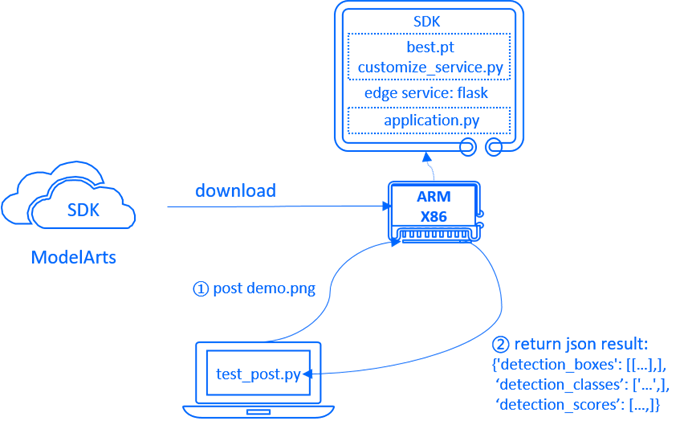

The edge service consists of three parts: the model inference SDK on the edge server, the service script on the edge server, and the testing script on the local PC.
The model inference SDK, including trained models and inference code, can be downloaded directly from ModelArts, the service script is built using Flask to set up an HTTP service on the edge server, and the testing script on the local PC loads test images and posts them to the edge server to obtain inference results.

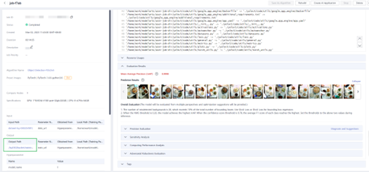

When the training job is completed, click Output Path to go to the OBS directory of the training job output:

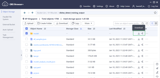

You will see a directory organized as this, the model directory is the inference SDK. We can download the SDK from OBS, click Download to download entire folder:

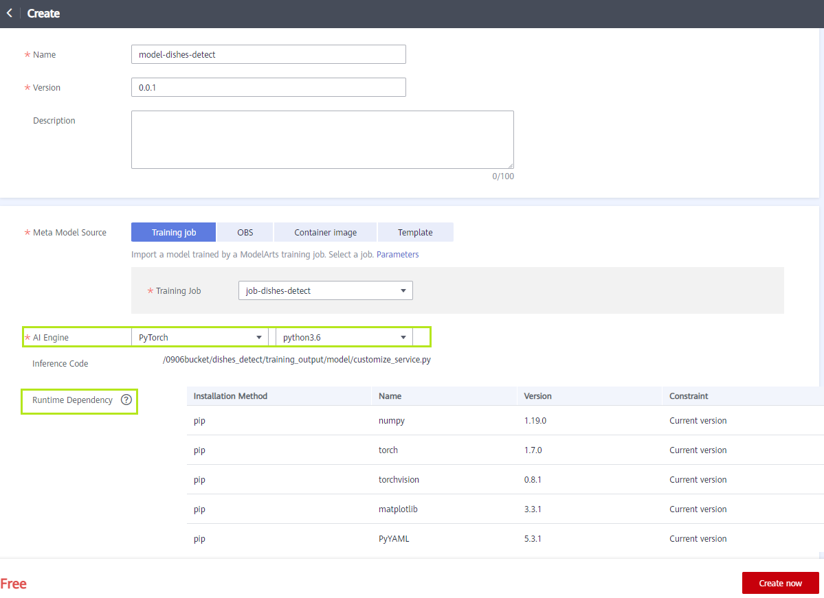

When deploying AI application, some dependences are needed. On the cloud, ModelArts will prepare the runtime environment, including some runtime dependencies and an AI engine with Pytorch and python3.6.
