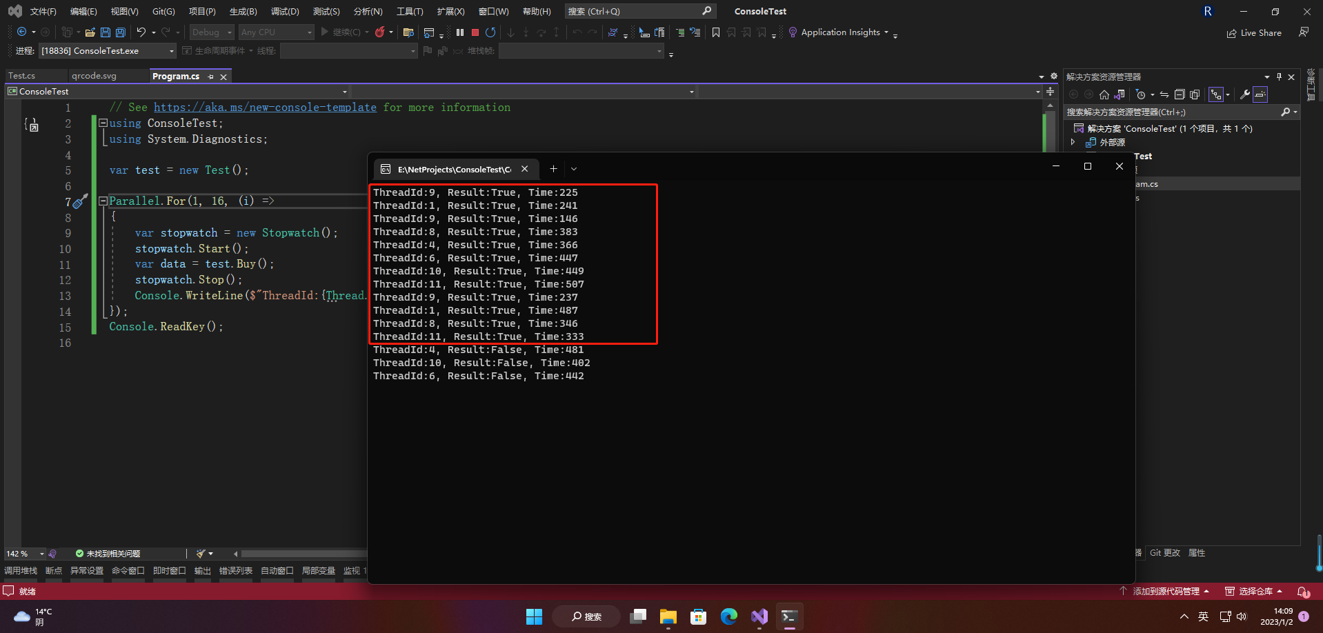

2、执行
模拟并行调用 Buy 方法 15 次(内部使用的是线程池,所以 ThreadId 会有重复),实际上只有 10 个库存,返回结果却显示 12 个请求都购买成功了。----超卖问题

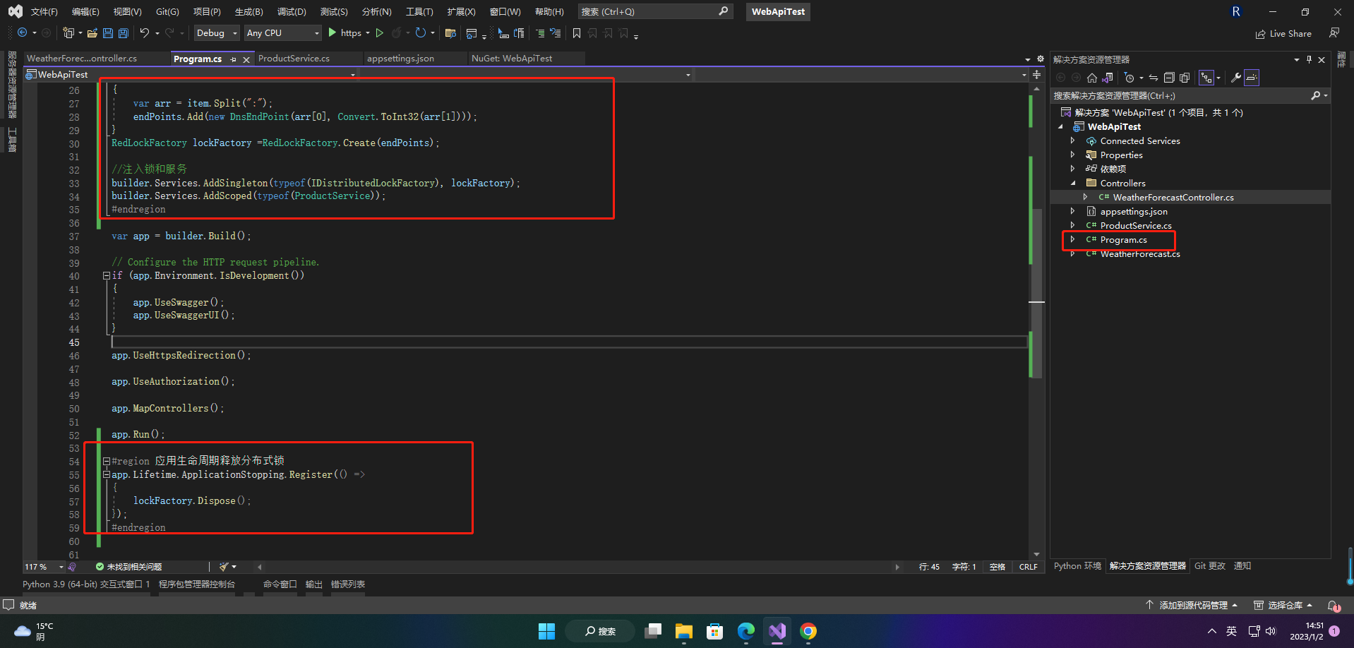

4、创建 RedLockFactory
using RedLockNet;
using RedLockNet.SERedis;
using RedLockNet.SERedis.Configuration;
using System.Net;
using WebApiTest;
var builder = WebApplication.CreateBuilder(args);
// Add services to the container.
builder.Services.AddControllers();
// Learn more about configuring Swagger/OpenAPI at https://aka.ms/aspnetcore/swashbuckle
builder.Services.AddEndpointsApiExplorer();
builder.Services.AddSwaggerGen();
#region 创建分布式锁
//创建分布式锁
var redisUrl = builder.Configuration["RedisUrl"];
if (string.IsNullOrEmpty(redisUrl))
    throw new ArgumentException("RedisUrl 不能为空");
var urls = redisUrl.Split(",").ToList();
var endPoints = new List<RedLockEndPoint>();
foreach (var item in urls)
    var arr = item.Split(":");
    endPoints.Add(new DnsEndPoint(arr[0], Convert.ToInt32(arr[1])));
RedLockFactory lockFactory =RedLockFactory.Create(endPoints);
//注入锁和服务
builder.Services.AddSingleton(typeof(IDistributedLockFactory), lockFactory);
builder.Services.AddScoped(typeof(ProductService));
#endregion
var app = builder.Build();
// Configure the HTTP request pipeline.
if (app.Environment.IsDevelopment())
    app.UseSwagger();
    app.UseSwaggerUI();
app.UseHttpsRedirection();
app.UseAuthorization();
app.MapControllers();
app.Run();
#region 应用生命周期释放分布式锁
app.Lifetime.ApplicationStopping.Register(() =>
    lockFactory.Dispose();
#endregion

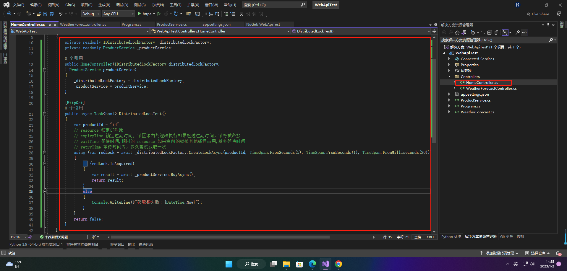

5、在HomeController添加方法DistributedLockTest
[ApiController]
[Route("[controller]/[action]")]
public class HomeController : ControllerBase
    private readonly IDistributedLockFactory _distributedLockFactory;
    private readonly ProductService _productService;
    public HomeController(IDistributedLockFactory distributedLockFactory,
      ProductService productService)
        _distributedLockFactory = distributedLockFactory;
        _productService = productService;
    [HttpGet]
    public async Task<bool> DistributedLockTest()
        var productId = "id";
        // resource 锁定的对象
        // expiryTime 锁定过期时间,锁区域内的逻辑执行如果超过过期时间,锁将被释放
        // waitTime 等待时间,相同的 resource 如果当前的锁被其他线程占用,最多等待时间
        // retryTime 等待时间内,多久尝试获取一次
        using (var redLock = await _distributedLockFactory.CreateLockAsync(productId, TimeSpan.FromSeconds(5), TimeSpan.FromSeconds(1), TimeSpan.FromMilliseconds(20)))
            if (redLock.IsAcquired)
                var result = await _productService.BuyAsync();
                return result;
            else
                Console.WriteLine($"获取锁失败:{DateTime.Now}");
        return false;

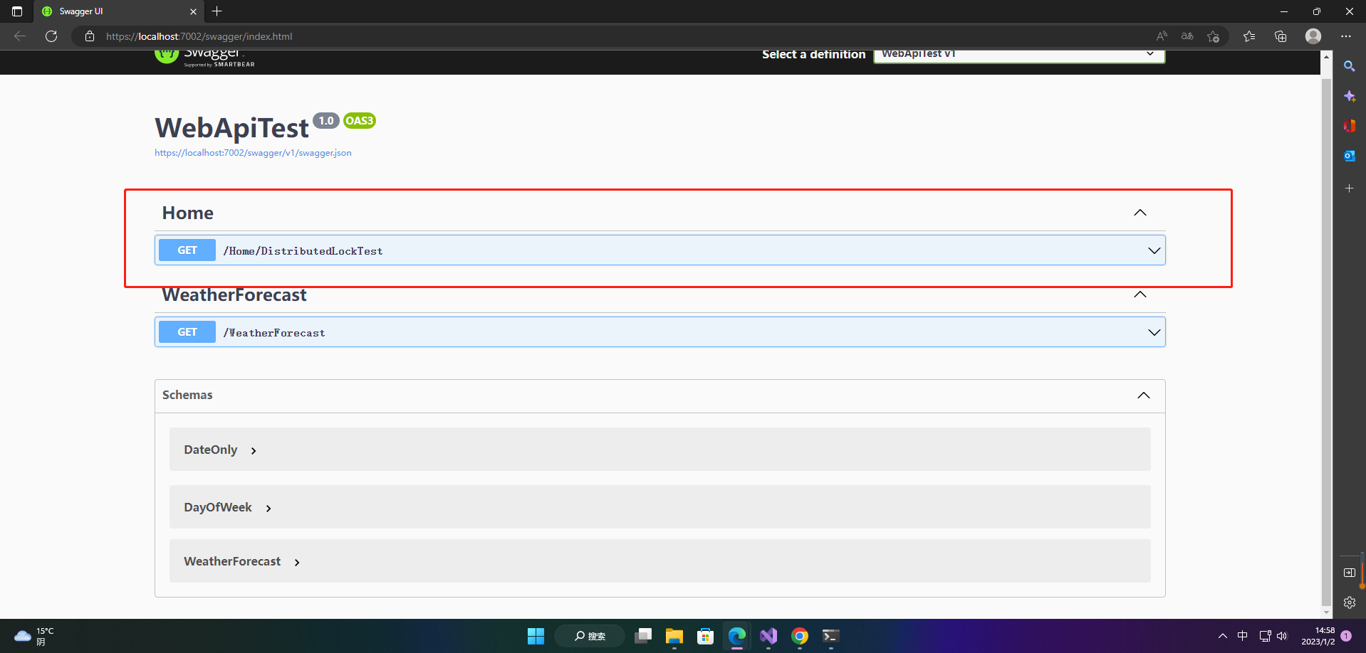

启动程序
