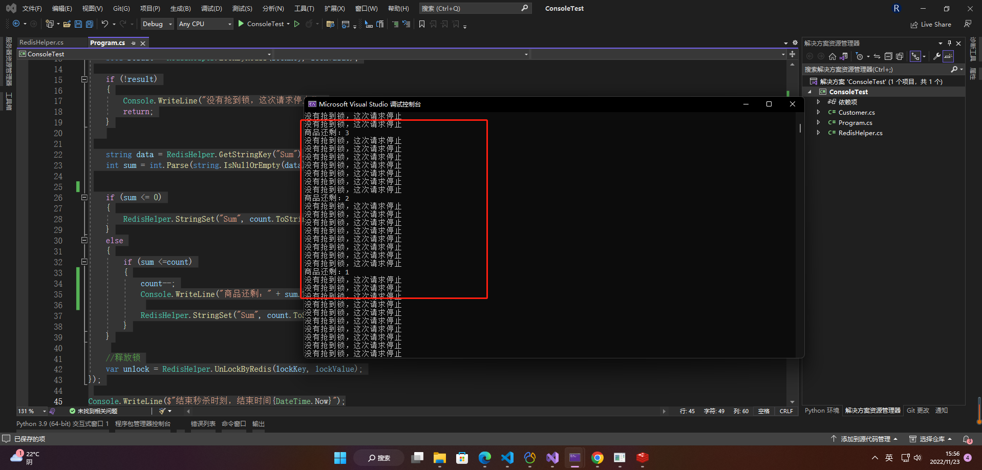

2.秒杀代码
using Redis;
int count=11;
Console.WriteLine($"进入秒杀时刻,进入时间{DateTime.Now}");
Parallel.For(0, 1000, i =>
    //锁键-值
    var lockKey = "lockKey";
    var lockValue = Guid.NewGuid().ToString("N");
    //加锁
    bool result = RedisHelper.LockByRedis(lockKey, lockValue);
    if (!result)
        Console.WriteLine("没有抢到锁,这次请求停止");
        return;
    string data = RedisHelper.GetStringKey("Sum").ToString();
    int sum = int.Parse(string.IsNullOrEmpty(data) ? "0" : data);
    if (sum <= 0)
        RedisHelper.StringSet("Sum", count.ToString());
    else
        if (sum <=count)
            count--;
            Console.WriteLine("商品还剩:" + sum.ToString());
    //释放锁
    var unlock = RedisHelper.UnLockByRedis(lockKey, lockValue);
Console.WriteLine($"结束秒杀时刻,结束时间{DateTime.Now}");
3.效果
