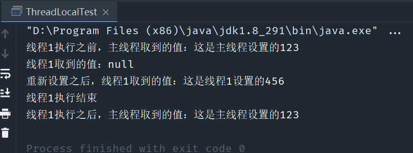

ThreadLocal示例
public class ThreadLocalTest {
    /** threadLocal变量,每个线程都有一个副本,互不干扰 */
    public static ThreadLocal<String> value = new ThreadLocal<>();
     * threadlocal测试
     * @throws Exception
    public void threadLocalTest() throws Exception {
        // threadlocal线程封闭示例
        value.set("这是主线程设置的123"); // 主线程设置值
        String v = value.get();
        System.out.println("线程1执行之前,主线程取到的值:" + v);
        new Thread(new Runnable() {
            @Override
            public void run() {
                System.out.println("线程1取到的值:" + v);
                // 设置 threadLocal
                value.set("这是线程1设置的456");
                v = value.get();
                System.out.println("重新设置之后,线程1取到的值:" + v);
                System.out.println("线程1执行结束");
        }).start();
        Thread.sleep(5000L); // 等待所有线程执行结束
        v = value.get();
        System.out.println("线程1执行之后,主线程取到的值:" + v);
    public static void main(String[] args) throws Exception {
        new ThreadLocalTest().threadLocalTest();
