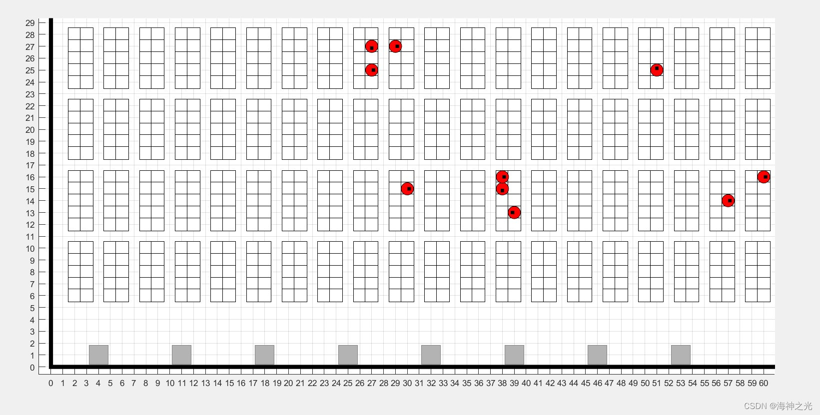

二、部分源代码
clear;
clc;
xlength=61;
ylength=29;
robotNum=10;
podNum=800;
depotNum = 8;
taskNum = robotNum;
xy2rc=@(x,y)[ylength+1-y;x];
rc2xy=@(r,c)[c;ylength+1-r];
sz=get(0,‘screensize’);
sz(1,2) = 80;
sz(1,4) = 950;
h=figure(‘outerposition’,sz);
assignin(‘base’,‘h’,h); %in case of any callback errors.
hold on;
grid on;
set(gca,‘xtick’,0:1:xlength);
set(gca,‘ytick’,0:1:ylength);
axis equal;
axis([0 xlength+1 0 ylength+1]);
axis manual;
% stores current states
globalTime = 1;
AllRobotState = zeros(robotNum,3);
AllPodState = zeros(podNum,3);
MapOccupancy = zeros(ylength,xlength);
RobotOccupancy = zeros(ylength,xlength);
[RobotStates,PodStates,DepotStates,StorageOccupancy]=initialize(xlength,ylength,robotNum,podNum,depotNum);
PodOccupancy = StorageOccupancy;
MapOccupancy = MapOccupancy+PodOccupancy;
%generate random tasks
TaskCell=cell(taskNum,1);
for i=1:taskNum
task=Task;
task.PodID=randi([1 podNum]);
task.StationID=randi([1 depotNum]);
task.ProcessTime=randi([5 20]);
task.ReturnState = zeros(1,3);
TaskCell{i,1}=task;
end
save(‘taskSet.mat’,‘TaskCell’);
load(‘taskSet.mat’);
%% Task Allocation
%% path planning problem
StartXYA = RobotStates;
GoalXYA = zeros(robotNum,3);
StartRCA = zeros(robotNum,3);
GoalRCA = zeros(robotNum,3);
temp= randperm(podNum);
for i=1:robotNum
StartRCA(i,1:2) = xy2rc(StartXYA(i,1),StartXYA(i,2));
StartRCA(i,3) = StartXYA(i,3);
GoalXYA(i,1:2) = PodStates(temp(i),1:2);
GoalRCA(i,1:2) = xy2rc(GoalXYA(i,1),GoalXYA(i,2));
GoalRCA(i,3) = randi([1 4]);
end
tic;
AllPathCell=MRPP_CBS(MapOccupancy,StartRCA,GoalRCA,0);
toc;
save(‘allPath.mat’,‘AllPathCell’,‘StartRCA’,‘GoalRCA’);
load(‘allPath.mat’);
futureSize=3;
HeatMap=cell(futureSize,1);
for i=1:futureSize
HeatMap{i,1}=zeros(robotNum,3);
end
%% plot results
video = VideoWriter(‘simulation’);
video.FrameRate=2;
open(video);
for loop=1:100
frame = getframe;
writeVideo(video,frame);
pause(0.5);
cla;
for i=1:robotNum
if ~isempty(AllPathCell{i,1})
path = AllPathCell{i,1};
if globalTime<=size(path,1)
state = path(globalTime,:);
AllRobotState(i,1:2)=rc2xy(state(1,1),state(1,2));
AllRobotState(i,3)=state(1,3);
end
for j=1:futureSize
if globalTime+j<=size(path,1)
state = path(globalTime+j,:);
temp = HeatMap{j,1};
temp(i,1:2)=rc2xy(state(1,1),state(1,2));
temp(i,3)=state(1,3);
HeatMap{j,1} = temp;
else
state = path(end,:);
end
end
end
end
AllPodState=PodStates;
plotAll(AllRobotState,AllPodState,DepotStates);
globalTime = globalTime + 1;
loop=loop+1;
end
close(video);
