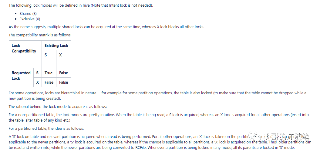

3.1 HIVE 传统的锁机制
HIVE 传统的锁机制,概括如下:
非分区表:For a non-partitioned table:
When the table is being read, a S lock is acquired; 读取操作会获取S锁
whereas an X lock is acquired for all other operations (insert into the table, alter table of any kind etc.) 其它操作会获取X锁
分区表:For a partitioned table, the idea is as follows:
A 'S' lock on table and relevant partition is acquired when a read is being performed; 读取操作或获取表和相关分区的S锁;
For all other operations, an 'X' lock is taken on the partition. However, if the change is only applicable to the newer partitions, a 'S' lock is acquired on the table, whereas if the change is applicable to all partitions, a 'X' lock is acquired on the table. Thus, older partitions can be read and written into, while the newer partitions are being converted to RCFile. Whenever a partition is being locked in any mode, all its parents are locked in 'S' mode. 其它操作,会获取分区的X锁;(可能会获取表的S或X锁)
如下官方链接,对此有详细的描述:https://cwiki.apache.org/confluence/display/Hive/Locking

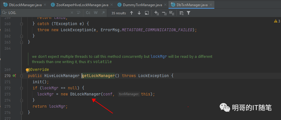

需要说明的是,当 hive.txn.manager 配置为 org.apache.hadoop.hive.ql.lockmgr.DbTxnManager 时,不管 hive.lock.manager 配置为 org.apache.hadoop.hive.ql.lockmgr.DbLockManager还是 org.apache.hadoop.hive.ql.lockmgr.zookeeper.ZooKeeperHiveLockManager,其底层实际使用的都是 org.apache.hadoop.hive.ql.lockmgr.DbLockManager,见源码:
