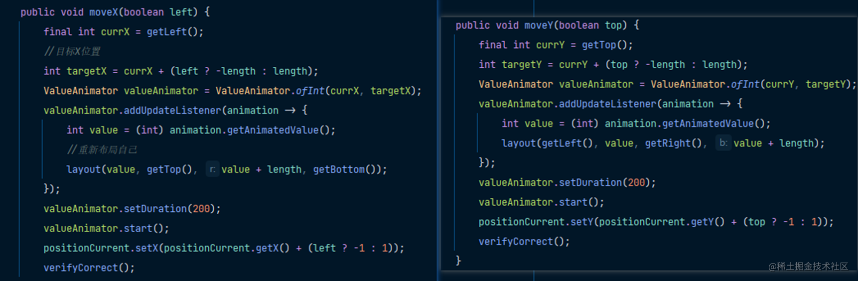

😜子View的移动

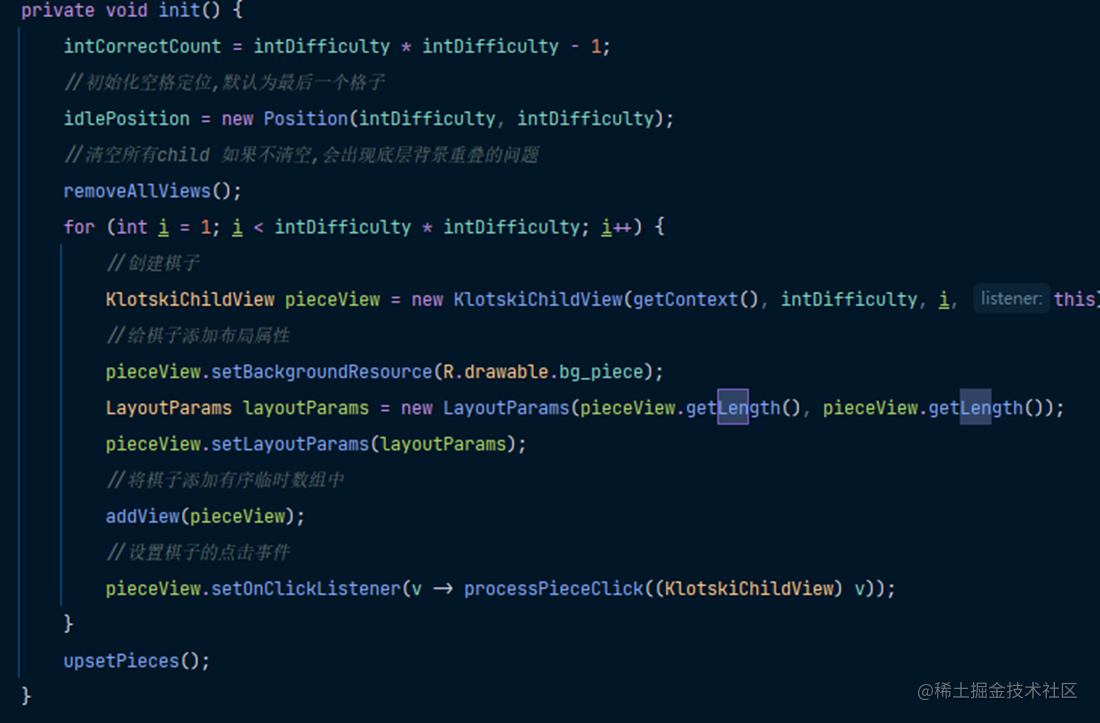

😜ViewGroup创建棋子

     * X轴移动
     * @param left 是否向左移动
    public void moveX(boolean left) {
        final int currX = getLeft();
        //目标X位置
        int targetX = currX + (left ? -length : length);
        ValueAnimator valueAnimator = ValueAnimator.ofInt(currX, targetX);
        valueAnimator.addUpdateListener(animation -> {
            int value = (int) animation.getAnimatedValue();
            //重新布局自己
            layout(value, getTop(), value + length, getBottom());
        valueAnimator.setDuration(200);
        valueAnimator.start();
        positionCurrent.setX(positionCurrent.getX() + (left ? -1 : 1));
        verifyCorrect();
     * Y轴移动
     * @param top 是否向上移动
    public void moveY(boolean top) {
        final int currY = getTop();
        int targetY = currY + (top ? -length : length);
        ValueAnimator valueAnimator = ValueAnimator.ofInt(currY, targetY);
            layout(getLeft(), value, getRight(), value + length);
        positionCurrent.setY(positionCurrent.getY() + (top ? -1 : 1));
        verifyCorrect();

    private void init() {
        intCorrectCount = intDifficulty * intDifficulty - 1;
        //初始化空格定位,默认为最后一个格子
        idlePosition = new ModelKlotskiPosition(intDifficulty, intDifficulty);
        //清空所有child 如果不清空,会出现底层背景重叠的问题
        removeAllViews();
        for (int i = 1; i < intDifficulty * intDifficulty; i++) {
            //创建棋子
            KlotskiChildView pieceView = new KlotskiChildView(getContext(), intDifficulty, i, this);
            //给棋子添加布局属性
            pieceView.setBackgroundResource(R.drawable.bg_piece);
            LayoutParams layoutParams = new LayoutParams(pieceView.getLength(), pieceView.getLength());
            pieceView.setLayoutParams(layoutParams);
            //将棋子添加有序临时数组中
            addView(pieceView);
            //设置棋子的点击事件
            pieceView.setOnClickListener(v -> processPieceClick((KlotskiChildView) v));
        upsetPieces();
