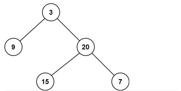

示例1:
输入:root = [3,9,20,null,null,15,7]
输出:2
示例2:
输入:root = [2,null,3,null,4,null,5,null,6]
输出:5
