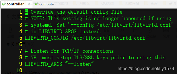

1.编辑/etc/sysconfig/libvirtd文件
[root@controller ~]# vi /etc/sysconfig/libvirtd
# Override the default config file
# NOTE: This setting is no longer honoured if using
# systemd. Set '--config /etc/libvirt/libvirtd.conf'
# in LIBVIRTD_ARGS instead.
LIBVIRTD_CONFIG=/etc/libvirt/libvirtd.conf
# Listen for TCP/IP connections
# NB. must setup TLS/SSL keys prior to using this
LIBVIRTD_ARGS="--listen"

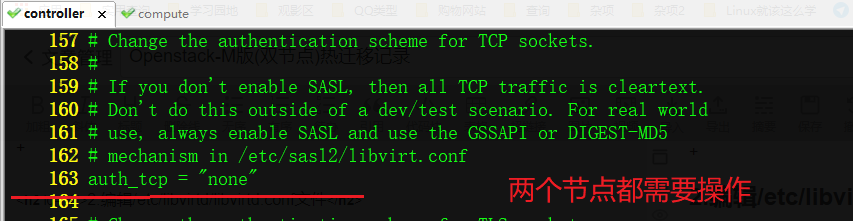

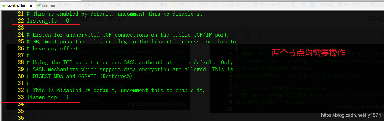

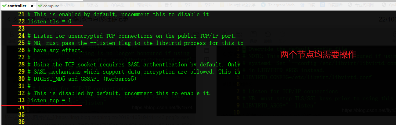

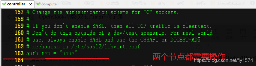

2.编辑/etc/libvirtd/libvirtd.conf文件
 22 listen_tls = 0
 23
 24 # Listen for unencrypted TCP connections on the public TCP/IP port.
 25 # NB, must pass the --listen flag to the libvirtd process for this to
 26 # have any effect.
 27 #
 28 # Using the TCP socket requires SASL authentication by default. Only
 29 # SASL mechanisms which support data encryption are allowed. This is
 30 # DIGEST_MD5 and GSSAPI (Kerberos5)
 31 #
 32 # This is disabled by default, uncomment this to enable it.
 33 listen_tcp = 1
 163 auth_tcp = "none"
  • 1
  • 2
  • 3
  • 4
  • 5
  • 6
  • 7
  • 8
  • 9
  • 10
  • 11
  • 12
  • 13
在这里插入图片描述在这里插入图片描述

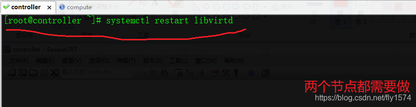

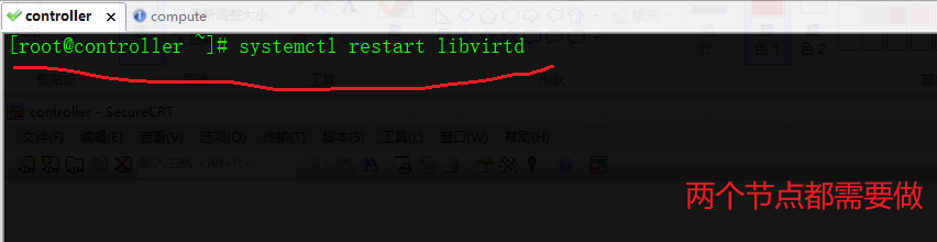

3.重启libvirtd服务
[root@controller ~]# systemctl restart libvirtd
  • 1
  • 2

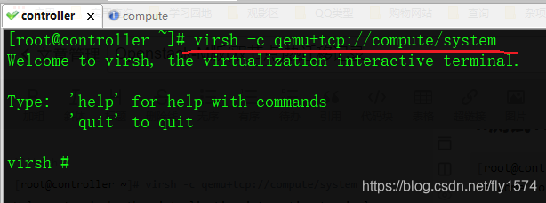

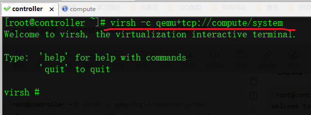

4.测试virsh链接
[root@controller ~]# virsh -c qemu+tcp://compute/system
Welcome to virsh, the virtualization interactive terminal.
Type:  'help' for help with commands
       'quit' to quit
virsh #
[root@conmpute ~]# virsh -c qemu+tcp://controller/system
       'quit' to quit
virsh #

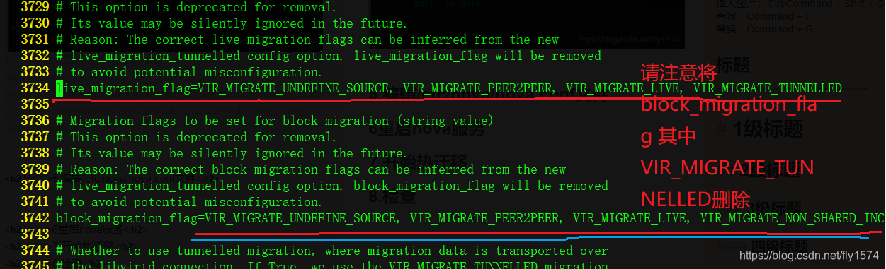

5.编辑/etc/nova/nova.conf文件
两个节点都需要操作
   3734 live_migration_flag=VIR_MIGRATE_UNDEFINE_SOURCE, VIR_MIGRATE_PEER2PEER, VIR_MIGRATE_LIVE, VIR_MIGRATE_TUNNELLED
   3735
   3736 # Migration flags to be set for block migration (string value)
   3737 # This option is deprecated for removal.
   3738 # Its value may be silently ignored in the future.
   3739 # Reason: The correct block migration flags can be inferred from the new
   3740 # live_migration_tunnelled config option. block_migration_flag will be removed
   3741 # to avoid potential misconfiguration.
   3742 block_migration_flag=VIR_MIGRATE_UNDEFINE_SOURCE, VIR_MIGRATE_PEER2PEER, VIR_MIGRATE_LIVE, VIR_MIGRATE_NON_SHARED_INC
  • 1
  • 2
  • 3
  • 4
  • 5
  • 6
  • 7
  • 8
  • 9
