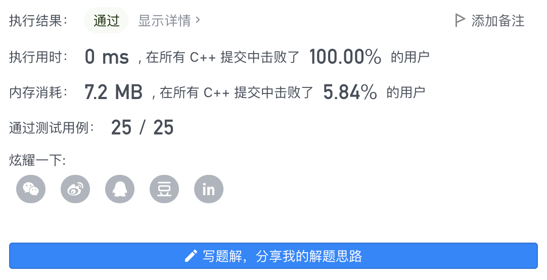

解答(C++)
方法一
class Solution {
public:
    vector<string> ans;
    void dfs(string& current, string digits, int n) {
        if(current.length() == digits.length()) {
            ans.push_back(current);
            return ;
        if(digits[n] == '2') {
            current += 'a';
            dfs(current, digits, n+1);
            current.pop_back();
            current += 'b';
            current.pop_back();
            current += 'c';
            current.pop_back();
        } else if (digits[n] == '3') {
            current += 'd';
            current.pop_back();
            current += 'e';
            current.pop_back();
            current += 'f';
            current.pop_back();
        } else if(digits[n] == '4') {
            current += 'g';
            current.pop_back();
            current += 'h';
            current.pop_back();
            current += 'i';
            current.pop_back();
        } else if(digits[n] == '5') {
            current += 'j';
            current.pop_back();
            current += 'k';
            current.pop_back();
            current += 'l';
            current.pop_back();
        } else if(digits[n] == '6') {
            current += 'm';
            current.pop_back();
            current += 'n';
            current.pop_back();
            current += 'o';
            current.pop_back();
        } else if(digits[n] == '7') {
            current += 'p';
            current.pop_back();
            current += 'q';
            current.pop_back();
            current += 'r';
            current.pop_back();
            current += 's';
            current.pop_back();
        } else if(digits[n] == '8') {
            current += 't';
            current.pop_back();
            current += 'u';
            current.pop_back();
            current += 'v';
            current.pop_back();
        } else {
            current += 'w';
            current.pop_back();
            current += 'x';
            current.pop_back();
            current += 'y';
            current.pop_back();
            current += 'z';
            current.pop_back();
    vector<string> letterCombinations(string digits) {
        if(digits.size() == 0) return ans;
        string current;
        dfs(current, digits, 0);
        return ans;
优化
class Solution {
public:
    vector<string> ans;
    void dfs(string& current, string digits, unordered_map<char, string> m, int n) {
        if(current.size() == digits.size()) {
            return ;
        string str = m[digits[n]];
        for(int i = 0; i < str.size(); ++i) {
            current.push_back(str[i]);
            dfs(current, digits, m, n+1);
            current.pop_back();
        if(digits.length() == 0) return ans;
        unordered_map<char, string> m{
            {'2',"abc"},
            {'3',"def"},
            {'4',"ghi"},
            {'5',"jkl"},
            {'6',"mno"},
            {'7',"pqrs"},
            {'8',"tuv"},
            {'9',"wxyz"}
        string current;
        dfs(current, digits, m, 0);
        return ans;
解答(Python)
