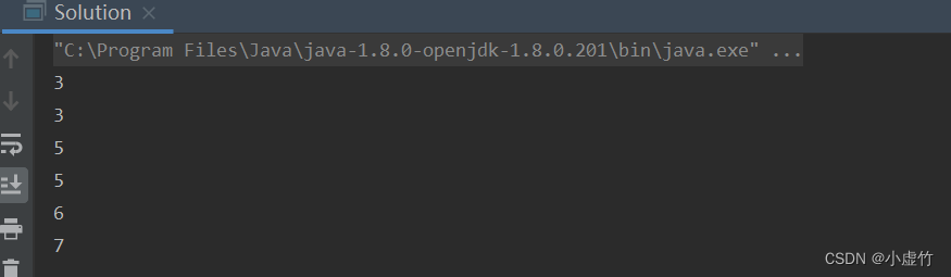

        int[] nums =new int[]{1,3,-1,-3,5,3,6,7};
        int k =3;
        int[] maxs =  maxSlidingWindow(nums,k);
        for (int max : maxs) {
            System.out.println(max);
    public static int[] maxSlidingWindow(int[] nums, int k) {

            if (rightIndex +1 >= k) {
                result[leftIndex] = nums[queueLinkedList.peekFirst()];
        return result;
