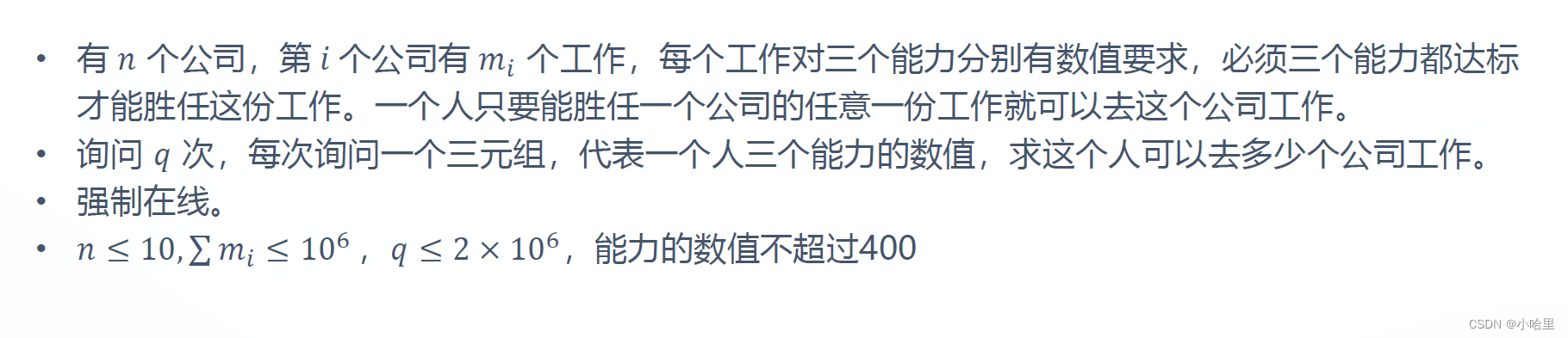

题意:
- 官方:
思路:
- 切入点是能力的数值不超过400,因此可以开出3维的状态,也可以跑出O(n^3)的数据。
考虑每一个工作(a,b,c)我们可以将数组中所有(>a,>b,>c)的位置都打上标记,即可知道第i个公司的某一份工作能否胜任。 - 考虑到10家公司4维的状态开不出来。对于10家公司,采用状态压缩的方式压位,用二进制表示每种工作的出现情况,预处理出三维前缀或,即可O(1)查询每个询问的情况。
- 最后,!!注意题目给的随机数种子,初始化 必须写在输入之后,不然默认都当成0去初始化了,就die了。

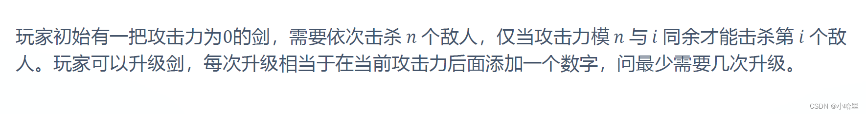

题目描述
See Problem N for PDF statements.
NIO is playing a new game. In this game, NIO has a sword with attack power represented by an integer AA. Initially, A=0A=0. There are also nn enemies in the game. NIO has to kill them in order, which means NIO must kill the (i-1)(i−1)-th enemy before killing the ii-th enemy for each ii (2\le i\le n2≤i≤n). For the ii-th enemy, NIO can kill it if and only if A\equiv i \pmod{n}A≡i(modn).
Fortunately, NIO can upgrade his sword at any moment for any number of times. Each time NIO upgrades his sword, he first chooses an integer xx (0\le x\le 90≤x≤9), then changes the attack power of the sword from AA to 10\times A+x10×A+x.
NIO wants to minimize the number of times to upgrade the sword so that he can win the game as fast as possible. Can you help him to find the minimum times?
输入描述:
The first line contains one integer nn (1\le n\le 10^{6}1≤n≤10
6
), indicating the number of enemies.
输出描述:
Output one integer indicating the minimum times to upgrade the sword.
示例1
输入
复制
4
输出
复制
4
说明
Here is a possible solution for the example:
- The attack power of the sword when killing the first enemy can be 10\times0+1=110×0+1=1.
- The attack power of the sword when killing the second enemy can be 10\times1+4=1410×1+4=14.
- The attack power of the sword when killing the third enemy can be 10\times14+7=14710×14+7=147.
- The attack power of the sword when killing the fourth enemy can be 10\times147+2=147210×147+2=1472.
So he needs to upgrade the sword at least four times.

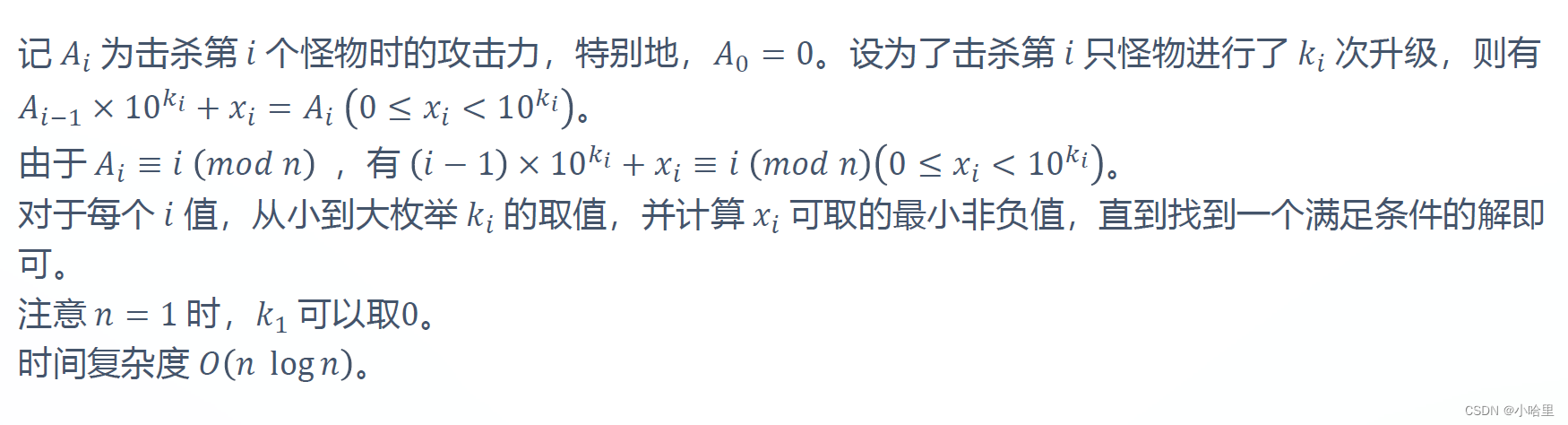

题意:
- 官方:
思路:
- 官方
#include<bits/stdc++.h>
using namespace std;
#define IOS ios::sync_with_stdio(0), cin.tie(0),cout.tie(0)
typedef long long LL;
const LL maxn = 1e6+10, mod = 1e9+7;
LL a[maxn], p[20];
int main(){
p[0] = 1; for(int i = 1; i < 8; i++)p[i] = p[i-1]*10;
int n; cin>>n;
if(n==1){ cout<<"0\n"; return 0; }
for(int i = 1; i <= n; i++){ //为了击杀第i只怪,又进行了ki次升级
for(int k = 1; k < 8; k++){ //枚举ki
LL x = (i-(i-1)*p[k]%n+n)%n; //xi = i-(i-1)*10^ki < 10^ki
if(x<p[k]){
a[i] = k; break;
LL ans = 0;
for(int i = 1; i <= n; i++)ans += a[i];
cout<<ans<<'\n';
return 0;

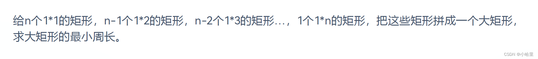

题目描述
As the builder employed by NIO, you need to build more walls for him. Now you have a number of bricks of height 11 but with different lengths. More precisely, you have nn bricks of length 11, n-1n−1 bricks of length 22, …, two bricks of length n-1n−1, and one brick of length nn. The width of the bricks is negligible. You need to build a wall with these bricks whose shape must be strictly rectangular. When building the wall, you must keep the height of the bricks at 11, which means you cannot rotate them.
Of course, you can definitely build a wall with a height of 11 and a large length, but it is not a beautiful wall. In NIO’s opinion, a beautiful wall should have the minimum possible circumference. Please tell him the minimum circumference of the wall, and how to build it.

Each test case contains an integer nn (1 \le n \le 1001≤n≤100) in a single line. It is guaranteed that the sum of nn over all test cases won’t exceed 200200.
输出描述:
For each test case, output an integer in a single line, indicating the minimum circumference of the wall. Then in the next \dfrac{n(n+1)}{2}
2
n(n+1)
lines, each line contains four integers x_1,y_1,x_2,y_2x
,y
,x
2
,y
2
, indicating that the coordinate of the lower left of the brick is (x_1,y_1)(x
,y
), and the upper right is (x_2,y_2)(x
2
,y
2
You can consider the wall as a rectangular in the Cartesian coordinate system, where the xx-axis represents the length and the yy-axis represents the height. The lower left of the wall must be located at (0,0)(0,0). If there are multiple solutions, output any.
示例1
输入
复制
4
2
3
4
输出
复制
4
0 0 1 1
8
0 1 1 2
1 1 2 2
0 0 2 1
14
2 1 3 2
3 1 4 2
4 1 5 2
3 0 5 1
0 1 2 2
0 0 3 1
18
4 0 5 1
2 3 3 4
3 3 4 4
4 3 5 4
3 1 5 2
3 2 5 3
0 3 2 4
0 1 3 2
0 2 3 3
0 0 4 1
说明
A possible solution for the third test case in the sample:

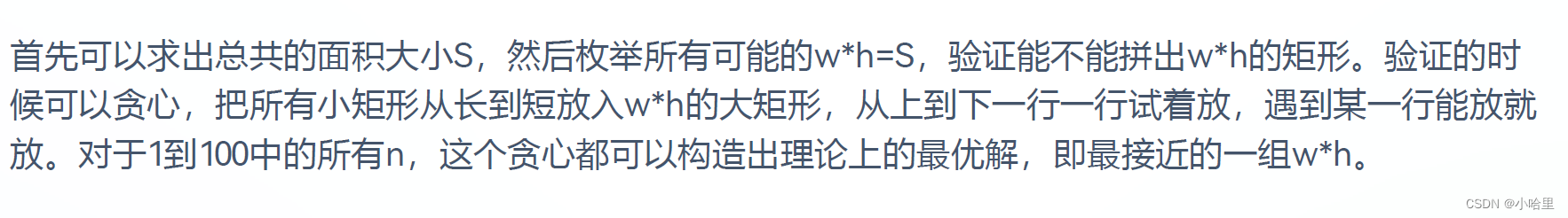

题意:
- 官方:
思路:
- 官方:
int cur[1200];//当前第i行的长度
vector<pair<int, int> >ans[120];
int check(int n, int h, int w){ //验证对于n能否拼出h*w的矩形
for(int i = 0; i < h; i++)cur[i] = 0;
for(int i = n; i >= 1; i--){ //矩形的长度,从长到短放入第k行
ans[i].clear();
int cnt = n-i+1; //1个1*n,2个1*n-1,...,n-1个1*2,n个1*1的矩形
for(int j = 0; j < cnt; j++){
int ok = 0;
for(int k = 0; k < h; k++){
if(cur[k]+i<=w){ //能放就放进去
ans[i].push_back({k,cur[k]});//长度i:第k行,左下角cur[k]
cur[k] += i;
ok = 1;
break;
if(!ok)return 0; //每一行都放不进去,那就再见
cout<<2*(h+w)<<"\n";
for(int j = 0; j < n-i+1; j++){
cout<<ans[i][j].second<<" "<<ans[i][j].first<<' '<<ans[i][j].second+i<<" "<<ans[i][j].first+1<<"\n";
return 1;
int main(){
int T; cin>>T;
while(T--){
int n; cin>>n;
int s = 0;
for(int i = 1; i <= n; i++) s += (n-i+1)*i;
vector<int>vc;
for(int i = 1; i*i <= s; i++){//枚举所有可行的长和宽
if(s%i!=0)continue;
vc.push_back(i);
for(int i = vc.size()-1; i >= 0; i--){//按照w+h从小到大判断是否可以拼出来
if(check(n, vc[i], s/vc[i]))break;
return 0;

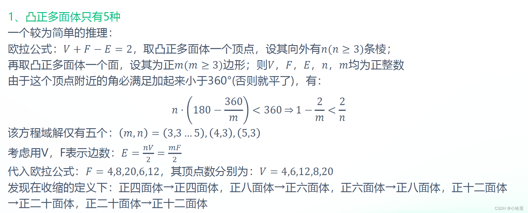

L.Black Hole
链接:https://ac.nowcoder.com/acm/contest/33189/L
来源:牛客网
题目描述

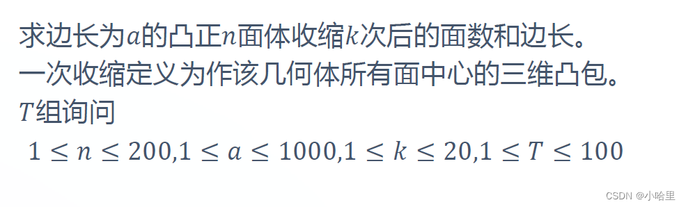

Equestria is a place full of friendship, magic, and mysteries. Thus, when Twilight Sparkle finds non-spherical black holes in the sky, she is curious rather than surprised.
Twilight Sparkle finds that each of the black holes is a convex regular polyhedron with nn faces (a convex polyhedron whose nn faces are identical regular polygons), and the length of its edges is aa.
Every day the black hole will shrink exactly once. If a black hole shrinks, it will become the convex hull of nn geometry centers of the original black hole’s nn faces. And whenever the black hole isn’t a regular polyhedron, it will disappear forever.
Twilight Sparkle has made TT records for the black holes she has observed. Each of the records can be described as a tuple (n,a,k)(n,a,k), indicating that a convex regular polyhedron black hole with edges of length aa and nn faces initially has shrunk kk times. However, naughty Rainbow Dash replaced some of the records with impossible ones. Can you find out the impossible records and calculate the final n’n
and a’a
after kk times of shrinking for those possible records?
输入描述:
The first line contains an integer TT (1\le T\le 100)(1≤T≤100), denoting the number of the records.
In the following TT lines, each line describes a record and contains three integers n,a,kn,a,k (1\le n\le 2001≤n≤200, 1\le a\le 10001≤a≤1000, 1\le k\le 201≤k≤20).
输出描述:
For each of the records, if the record is impossible, output \texttt{impossible}impossible in a single line. Otherwise, output \texttt{possible}possible followed by an integer n’n
and a real number a’a
in a single line, separated by spaces. a’a
is considered correct if the relative or absolute error between yours and the standard solution is not greater than 10^{-6}10
−6
示例1
输入
复制
3
2 10 1
4 10 1
6 10 1
输出
复制
impossible
possible 4 3.333333333333
possible 8 7.071067811865
说明
For the first record, it’s impossible to find a convex regular polyhedron with 22 faces.
For the second record, a 44-face convex regular polyhedron is a tetrahedron. After taking all its faces’ geometry centers to make a convex hull, we get a smaller tetrahedron.
For the third record, a 66-face convex regular polyhedron is a cube. After taking all its faces’ geometry centers to make a convex hull, we get an octahedron, a.k.a. an 88-face convex regular polyhedron.

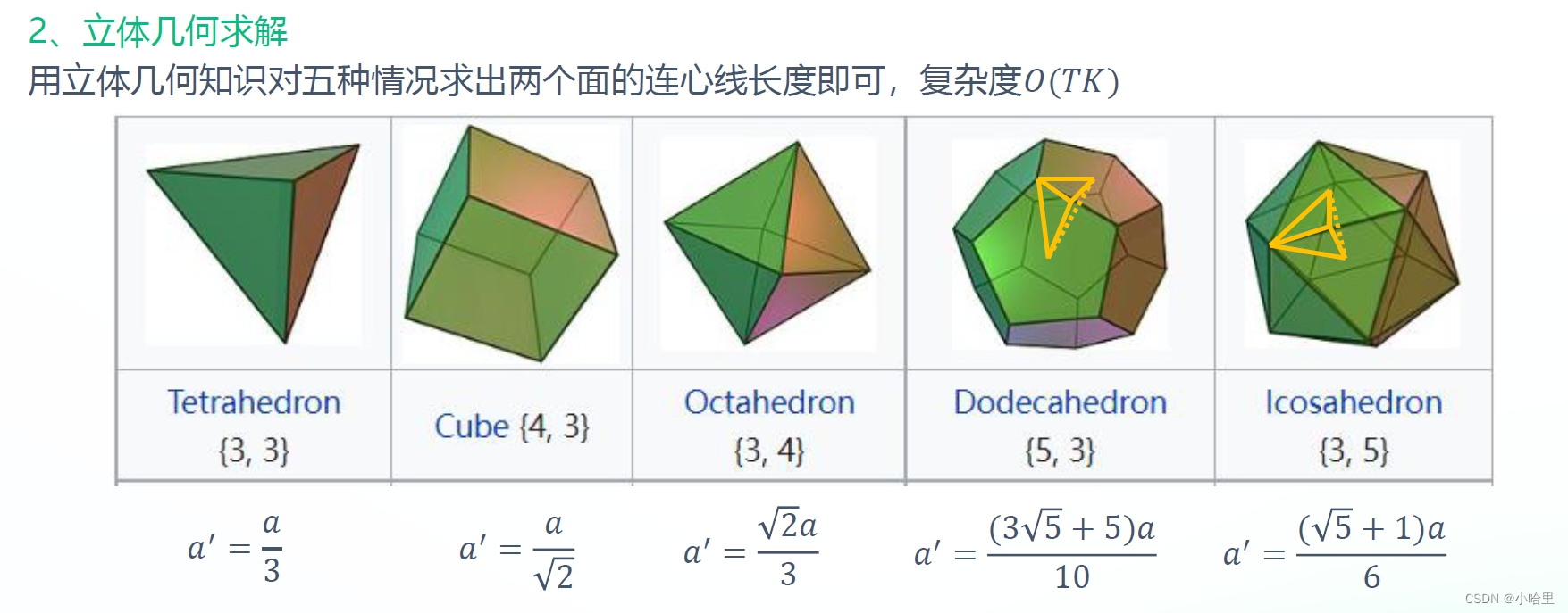

题意:
- 官方:
思路:
- 官方:
long double pi = acosl(-1);
void shrink(int &n, long double &a){ //一次收缩操作
int cnt=-1; long double c; //面数,边长

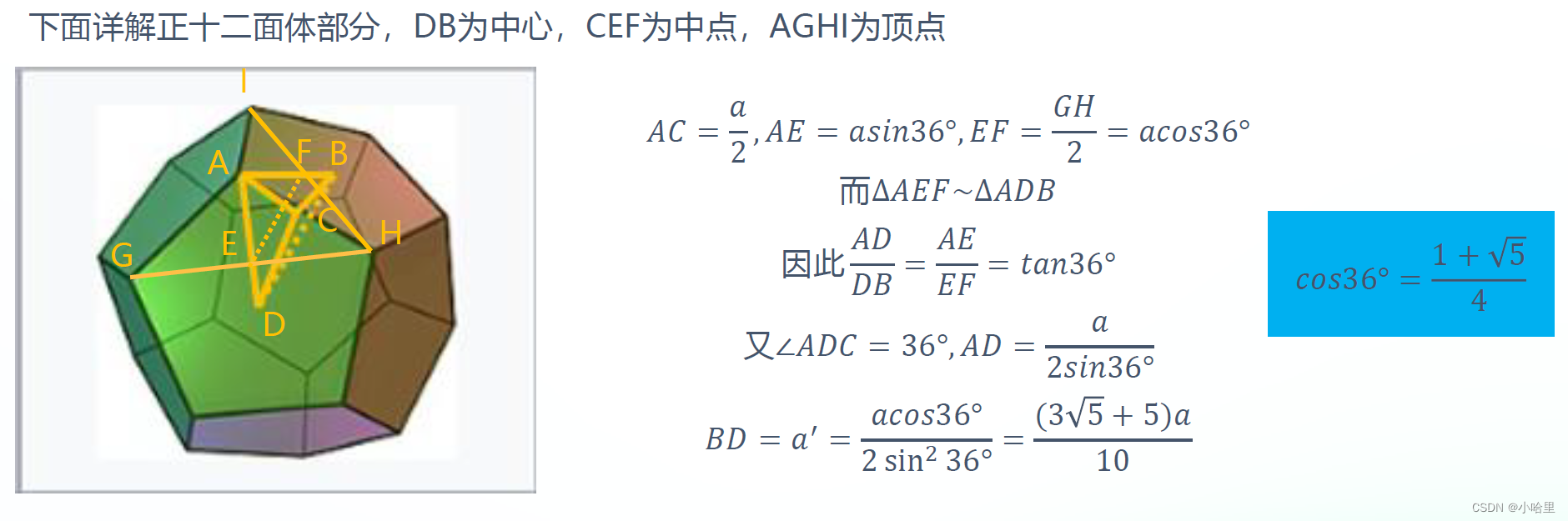

if(n==-1)return ;
if(n==4){ cnt = 4; c = a/3; }
if(n==6){ cnt = 8; c = a/sqrtl(2); }
if(n==8){ cnt = 6; c = sqrtl(2)*a/3; }
if(n==12){ cnt = 20; c = a*(3*sqrtl(5)+5)/10; }
if(n==20){ cnt = 12; c = a*(sqrtl(5)+1)/6; }
n = cnt, a = c;
int main(){
int T; cin>>T;
while(T--){
int n, k; long double a; cin>>n>>a>>k;
while(k--)shrink(n,a);
if(n==-1)cout<<"impossible\n";
else printf("possible %d %.12Lf\n", n, a);
return 0;
