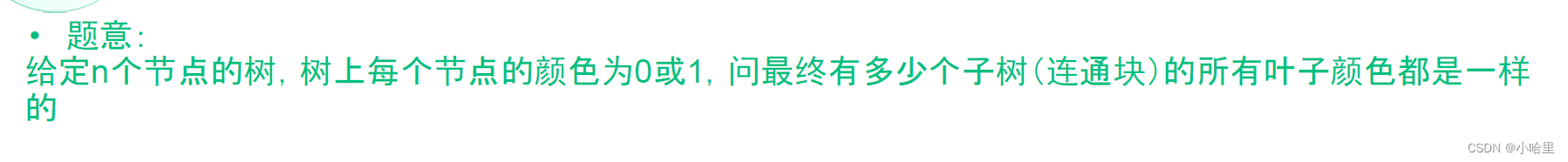

One day, when NIO was walking under the tree, he found that there are birds standing on the tree, and each bird is standing on one leaf. He wondered about in how many sub-trees form by connected vertex-induced subgraphs from the original tree, all birds are in the same gender. The number would be very large, just mod 10^9+710
9
+7 in the output.
输入描述:
There are multiple input cases.
For each case, the first line contains an integer, nn, denoting the number of nodes on the tree. The second line is a binary string, where 11 denotes the male birds and 00 denotes the female birds.
Following by n-1n−1 lines. In each line there are two integers, x_i, y_ix
i
,y
i
, denoting there is a path connecting node xx and node yy.
1\leq n \leq 3\times10^5, 1\leq x_i,y_i \leq N1≤n≤3×10
5
,1≤x
i
,y
i
≤N
输出描述:
Output a number module 10^9+710
9
+7, the number of subgraphs of the given tree that form trees where all its leaves are the same color.
示例1

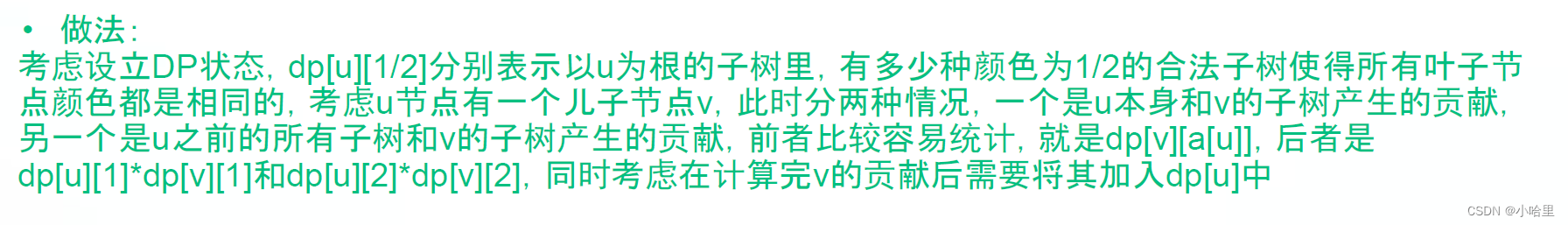

题意:
- 官方:
思路:
- 官方:

//赛后AC
#include<bits/stdc++.h>
using namespace std;
typedef long long LL;
const LL maxn = 1e6+10, mod = 1e9+7;
string s;
LL f[maxn][2], ans = 0, n;
vector<int>G[maxn];
void dfs(int u, int fa){
f[u][0] = f[u][1] = 1;
LL x = 0, y = 0;
for(int v : G[u]){
if(v==fa)continue;
dfs(v,u);
f[u][0] = (f[u][0]*(f[v][0]+1))%mod;
f[u][1] = (f[u][1]*(f[v][1]+1))%mod;
x = (x+f[v][0])%mod;
y = (y+f[v][1])%mod;
if(s[u]-'0'){
f[u][0]--;
ans = (ans+f[u][1])%mod;
ans = ((ans+f[u][0]-x)%mod+mod)%mod;
}else{
f[u][1]--;
ans = (ans+f[u][0])%mod;
ans = ((ans+f[u][1]-y)%mod+mod)%mod;
int main(){
cin>>n>>s; s="0"+s;
for(int i = 1; i < n; i++){
int u, v; cin>>u>>v;
G[u].push_back(v);
G[v].push_back(u);
dfs(1,0);
cout<<ans<<"\n";
return 0;
