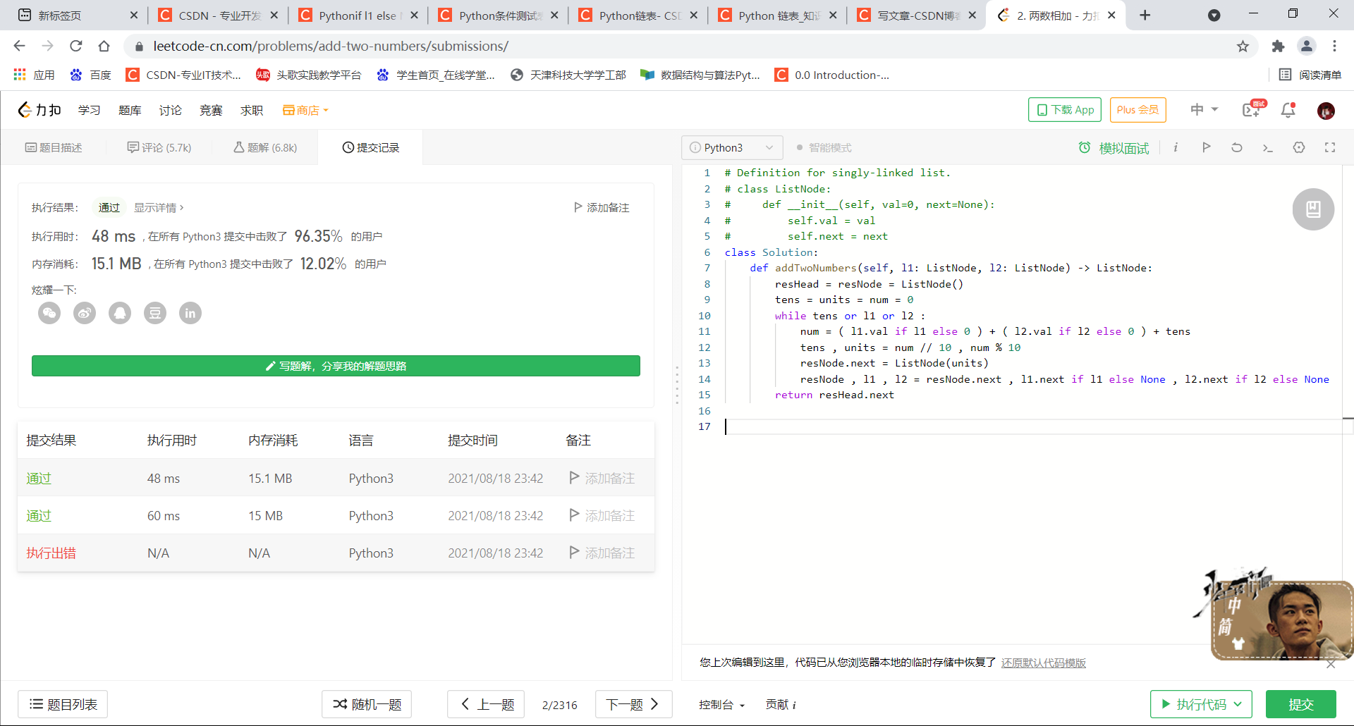

# Definition for singly-linked list.
# class ListNode:
#     def __init__(self, val=0, next=None):
#         self.val = val
#         self.next = next
class Solution:
    def addTwoNumbers(self, l1: ListNode, l2: ListNode) -> ListNode:
        resHead = resNode = ListNode()
        tens = units = num = 0
        while tens or l1 or l2 :
            num = ( l1.val if l1 else 0 ) + ( l2.val if l2 else 0 ) + tens
            tens , units = num // 10 , num % 10
            resNode.next = ListNode(units)
            resNode , l1 , l2 = resNode.next , l1.next if l1 else None , l2.next if l2 else None
        return resHead.next
