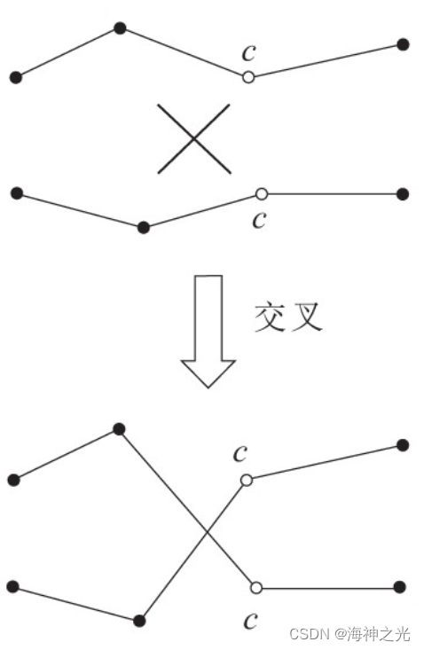

2 交叉
定义交叉概率pc, 在[0, 1]之间取随机值pcr, 若pcr≤pc, 则进行交叉操作。
交叉操作如图3所示, 进行交叉操作时, 对于中心元胞个体Qcen和被选中的邻居元胞个体Qngb, 除去初始点和终点, 分别选择第c个航点, 将其和前一个航点断开, 将Qcen的c-1航点和Qngb的c航点相连, 将Qngb的c-1航点和Qcen的c航点相连, 分别计算新生成的2个航迹适应度, 选取适应度大的进入下一代, 记为Qnew。
图3 交叉操作

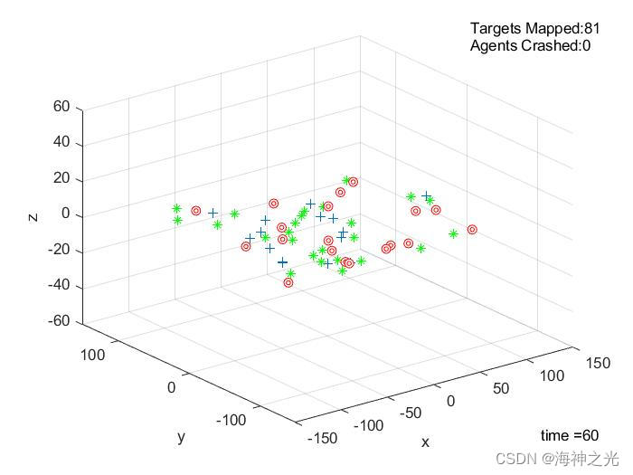

%% Objects and Interactions Parameters
Nm = 15; %Number of initial agents
No = 25; %Number of initial obstacles
Nt = 100; %Number of initial targets
%% Initialize Target, Obstacle, and Swarm Locations
x_range = 100;
y_range = 100;
z_range = 10;
%Targets and obstacles randomly positioned throughout the region.
targets = [2*x_range*rand(1,Nt)-x_range;
2*y_range*rand(1,Nt)-y_range;
2*z_range*rand(1,Nt)-z_range];
obstacles = [2*x_range*rand(1,No)-x_range;
2*y_range*rand(1,No)-y_range;
2*z_range*rand(1,No)-z_range];
%Agents can be purposefully arranged. Right now they are randomly placed.
agents = [[linspace(-150,-110,5),linspace(-150,-110,5),linspace(-150,-110,5)];
[zeros(1,5)-10,zeros(1,5),zeros(1,5)+10];
zeros(1,15)];
% agents = [[linspace(-150,-130,5),linspace(-150,-110,5),linspace(-150,-110,5)];
% [zeros(1,5)-2,zeros(1,5),zeros(1,5)+2];
% [zeros(1,5)-2,zeros(1,5),zeros(1,5)-2]];
%agents = [linspace(-150,-110,Nm);zeros(1,Nm);zeros(1,Nm)];

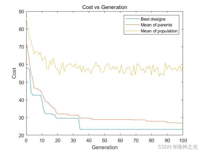

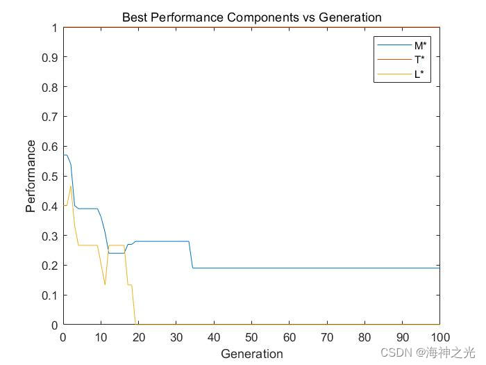

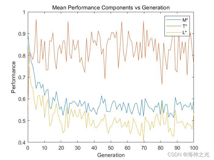

%% Genetic Algorithm without reevaluating parents
% [PI, Orig, Lambda] = geneticAlgorithm3(cf, lambda_lower, lambda_upper, parents, TOL_GA, G, S, dv)
w1 = 70;
w2 = 10;
w3 = 20;
cf = @(M_star,T_star,L_star) w1*M_star+w2*T_star+w3*L_star;
lambda_lower = 0;
lambda_upper = 2;
parents = 6;
TOL_GA = 0.1;
G = 100;
S = 20;
dv = 15;
% Generate empty output arrays.
PI = zeros(G,S);
Orig = zeros(G,S);
PC = zeros(G,S,3);
% Randomly generate first generation.
Lambda = lambda_lower + rand(S,dv).*(lambda_upper-lambda_lower);
t0 = tic;
for g = 1:G
myProgressBar(toc(t0), g, G);
% Test fitness of members of first generation.
if (g == 1)
for i = 1:S
lambda = Lambda(i,:);
[L_star,M_star,T_star] = swarmSim2(obstacles, targets, agents, lambda, false);
PI(g,i) = cf(M_star,T_star,L_star);
PC(g,i,:) = [M_star,T_star,L_star];
end
else
PI(g,1:parents) = PI(g-1,1:parents);
PC(g,1:parents,:) = PC(g-1,1:parents,:);
for i = parents+1:S
end
end
