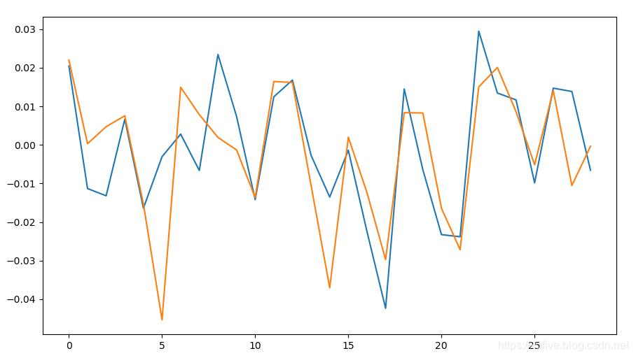

最后,我们综合运用统计函数,分析两只股票的关联关系和收益率。pa 和 pb 是两只股票连续30个交易日的股价数组。每日股价收益率定义为当日股价与前一个交易日股价差除以最后一个交易日的股价。
>>> pa = np.array([79.66, 81.29, 80.37, 79.31, 79.84, 78.53, 78.29, 78.51, 77.99, 79.82, 80.41, 79.27, 80.26, 81.61, 81.39, 80.29, 80.18, 78.38, 75.06, 76.15, 75.66, 73.90, 72.14, 74.27, 75.27, 76.15, 75.40, 76.51, 77.57, 77.06])
>>> pb = np.array([30.93, 31.61, 31.62, 31.77, 32.01, 31.52, 30.09, 30.54, 30.78, 30.84, 30.80, 30.38, 30.88, 31.38, 31.05, 29.90, 29.96, 29.59, 28.71, 28.95, 29.19, 28.71, 27.93, 28.35, 28.92, 29.17, 29.02, 29.43, 29.12, 29.11])
>>> np.corrcoef(pa, pb) # 两只股票的相关系数为0.867,关联比较密切
array([[1.        , 0.86746674],
       [0.86746674, 1.        ]])
>>> pa_re=np.diff(pa)/pa[:-1]
>>> pb_re=np.diff(pb)/pb[:-1]
>>> import matplotlib.pyplot as plt
>>> plt.plot(pa_re)
[<matplotlib.lines.Line2D object at 0x000002262AEBD9C8>]
>>> plt.plot(pb_re)
[<matplotlib.lines.Line2D object at 0x000002262BB96408>]
>>> plt.show()
两只股票的收益率变化曲线如下图所示:
