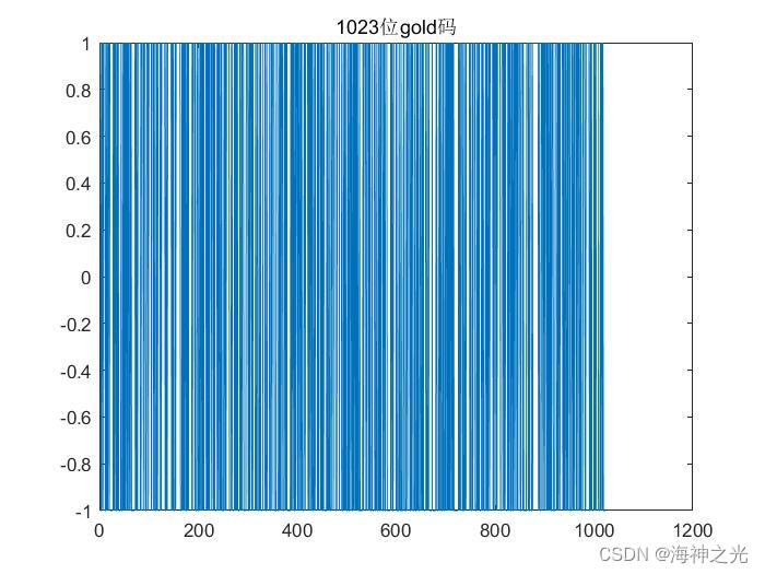

% 产生伪随机码,看cacode.m
w_code=cacode(PRN);
figure(1);
plot(w_code);
title('1023位gold码');

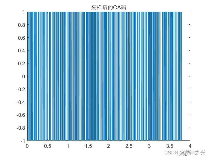

%对CA码进行采样
samplecacodes = makeCaTable(PRN,codeLength,chiprate,samplingFreq);
figure(2);
plot(samplecacodes);
title('采样后的CA码');

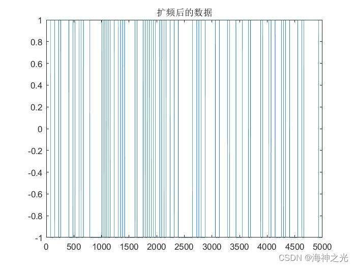

figure(4);
plot(spread_code(1:5000));%这块注意只是取了5000个数据实际上有38192个
title('扩频后的数据')

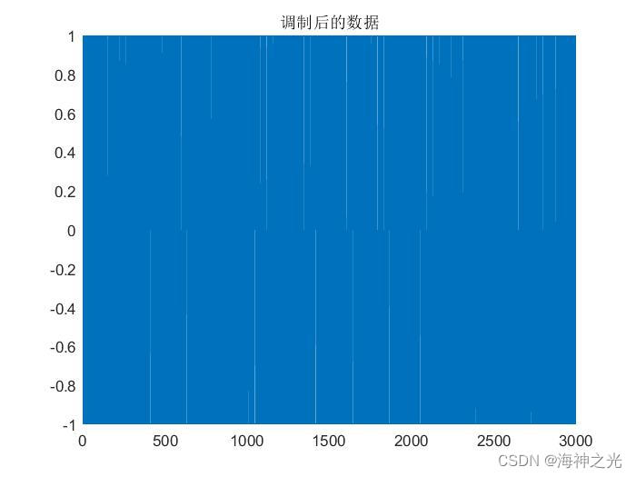

%调制
t = (0:(samplesPerCode-1))/samplingFreq;
sendeddata=spread_code.*cos(2*pi*IF.*t);
figure(5);
plot(sendeddata(1:3000));
title('调制后的数据');
