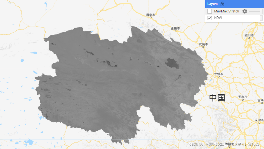

var ss = ee.FeatureCollection("users/bqt2000204051/Qinghai");
var NDVIImgColl = ee.ImageCollection('LANDSAT/LC08/C01/T1_8DAY_NDVI')
                  .filterDate('2018-11-01', '2019-04-30').select('NDVI').mean();
Map.addLayer(NDVIImgColl.clip(ss), {}, "NDVI")
var NDVIavg = NDVIImgColl.clip(ss)
var stats = NDVIavg.reduceRegion({
    reducer: ee.Reducer.minMax(),
    geometry : ss,
    scale : 30,
    maxPixels: 1e10
var varmax1 = ee.Number(stats.get("NDVI_max"));
print("Max NDVI in AOI", varmax1)
// evaluate() 将在后台运行,而 最小/最大值的计算

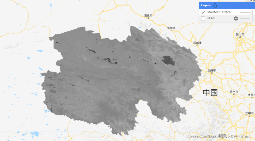

stats.evaluate(function(result) {
  var min = result['NDVI_min']
  var max = result['NDVI_max']
  print('Computed min/max', min, max)
  var visParams = {min: min, max:max}
  Map.addLayer(NDVIImgColl.clip(ss), visParams, 'Min/Max Stretch');
这里没有best effort的运行状态,一致再加载:
    geometry : ss,
    scale : 30,
    maxPixels: 1e10,
bestEffort:true
使用后的bestEffort参数结果:
NDVI均值:
 最大最小值:
