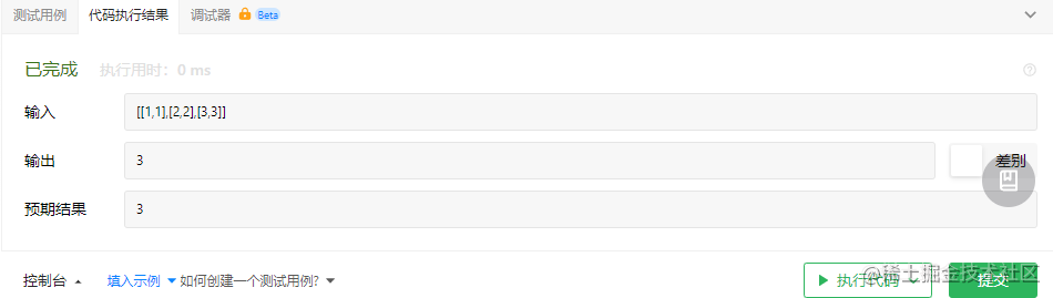

示例 1:
输入: points = [[1,1],[2,2],[3,3]]
输出: 3
